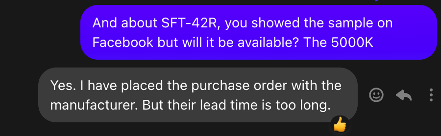

Hi @Simon_Mao I see the video of Weerapat Kiatdumrong with SFT42R in 5000k and the tint aparently it’s nice. When it will be become available in your shop? I want it with the M21B.

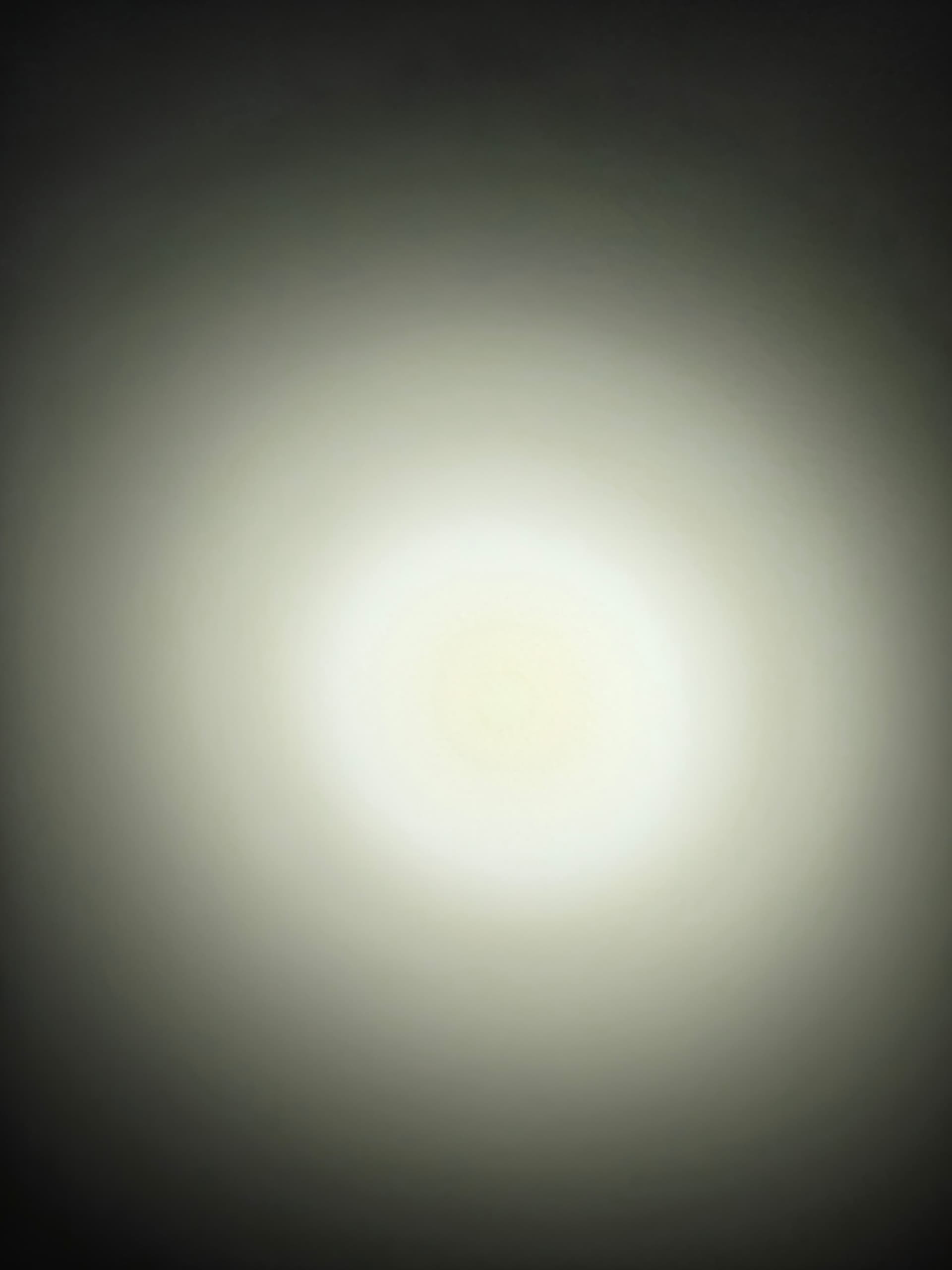

I bought some SFT-42R 5000k from Kaidoman and installed them in an M21B to unfortunately find that it had the same green hot-spot that SFT-25R 5000k does, I hope that Simon’s bin doesn’t have the same issue but his SFT-25R bin did unfortunately.
10 Thanks
How hard are you driving it?
10 amps, since Simon doesn’t have an 11 amp driver.

I’m convinced that miscolored hotspots might have something to do with the oblique angles at which the LED’s phosphor throws reflects light. That in conjunction with the tint shift that might occur at higher currents.
What you explained is the cause of angular tint shift, which results in a green corona, not a green hotspot center. The latter is caused by uneven phosphor deposition, and can often be checked by projecting the image of the LED onto a white surface. For some reason, lots of recent Luminus emitters, starting with the SFT25R 5000K, seem to have this issue. Even koef3’s test sample of the cool white SFT42R has a very slight case.

Please explain - not sure I understand: why would an uneven application produces a perfect round green hotspot center? Wouldn’t it just result in an uneven colored hotspot? ie the round hotspot is there to begin with, uneven application results in uneven surface color, not creating a round colored circle.
