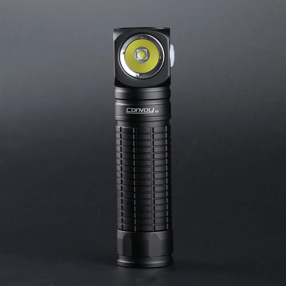

I see the H1 is (back?) on the Ali store. Different knurling. I’m guessing with the updated UI that’s been talked about?
ZozzV6
(ZozzV6)
1839
And does it has now the updated headband?
80T
(80T)
1840
I can see in the page description that it's running Biscotti.
Also in one of the pictures you can notice the cut-out in the driver and a mechanical switch going flush with the cut-out.
