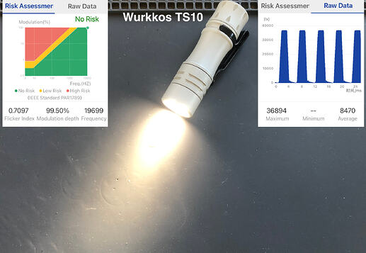

This is what the Original TS10 Fet+1 driver looks like on the Opple Flicker Index test:
The minimum output with that driver is 0.02 lm

that is a great improvement in terms of lower Flicker Index and NoPWM, compared to the original stock Fet+1 driver in the TS10

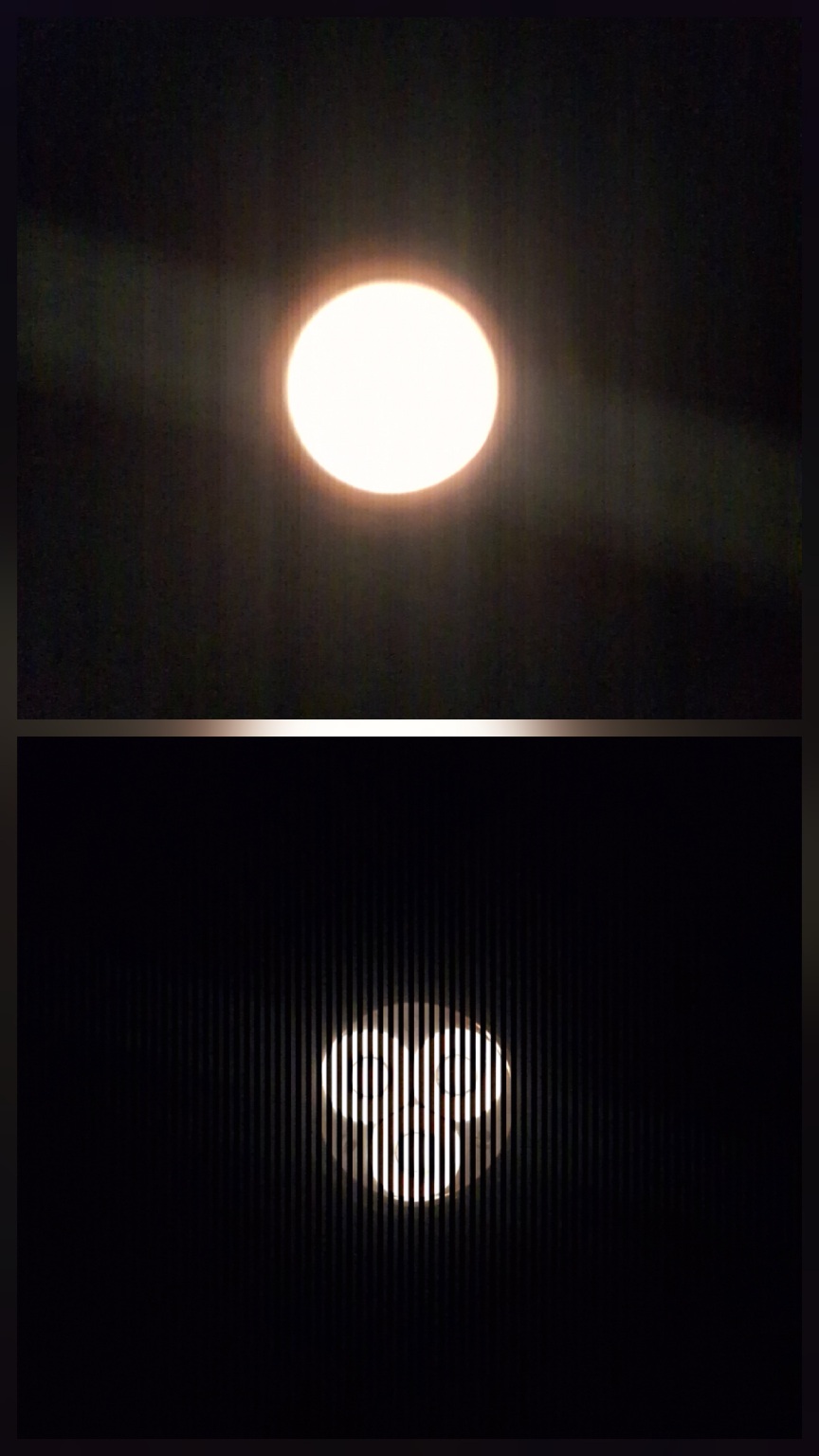

I guess I exaggerated the problem with SC13Cu’s driver.
Here how it compares to TS10v2 (both 3000K).
1/6000s speed, SC13 lvl1, TS10v2 ~lvl15.
yes, the Opple test of the Sofirn Copper SC13 Buck driver shows a modulation depth of just 7%, and the Lux Riple is just 17%
