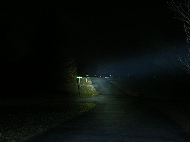

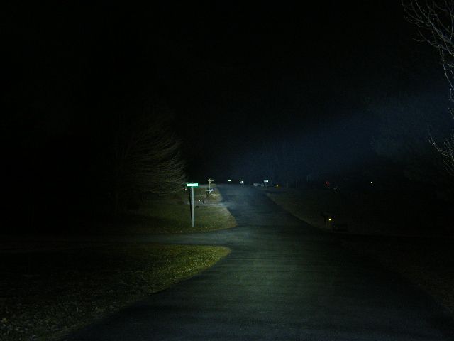

Here’s some beamshots comparing the 2 at various distances. There was a lot of particles in the air tonite, and the moon was out as well. Not near as close as I thought it would be. I was going to wait to do this coming Monday nite, but I got a sudden burst of energy after a little nap.
Camera settings were man exposure 2 sec shutter, f/3.5 and ISO 200.
110yds
Crelant 7G9
L3 Illumination K40

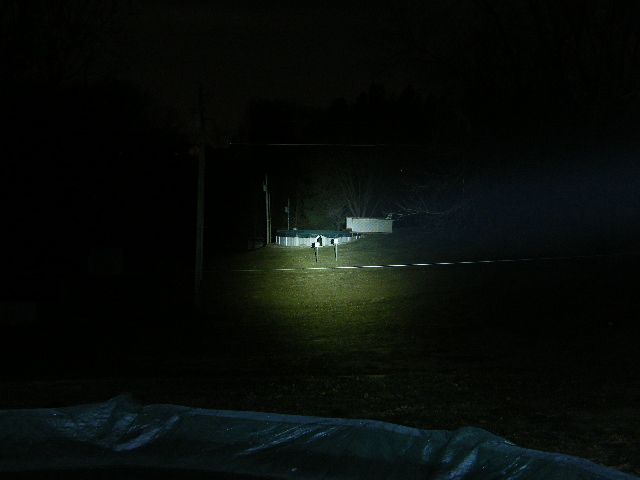

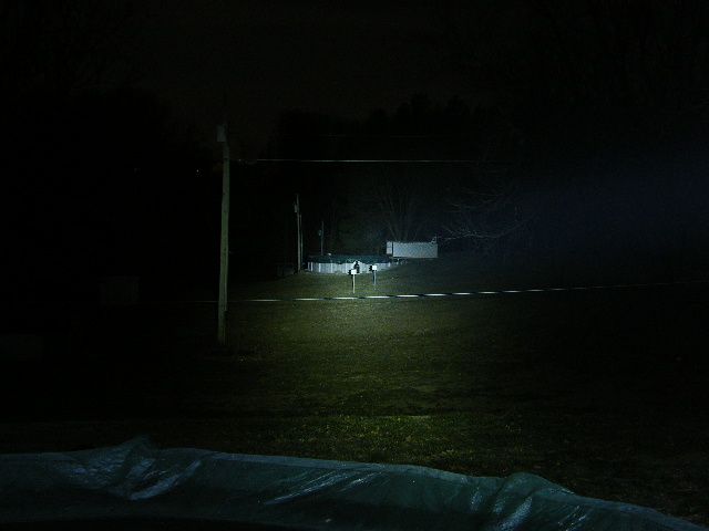

220yds to trees behind last electrc pole
Crelant 7G9
L3 K40

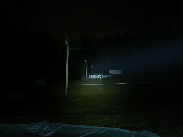

300yds
Crelant 7G9
L3 K40
Man the 7g9 showing its age.
Too bad its so hard to mod them. The build quality is great.
I can’t think about drilling the driver on mine.
Selfbuilt has the 7G9 listed at 63,000 lux with his new light meter. I figured that might be a little low judging by how it kills the Crelant 7G5 on the wall. I’m guessing it’s around 70,000 lux. But the L3 K40 still beats it easily. But the L3 K40 is very close to 90,000 lux. But nonetheless the Crelant 7G9 has a very deep reflector and is still one heck of a flashlight. Just wished it had mode memory. But other than that the quality is very good.
