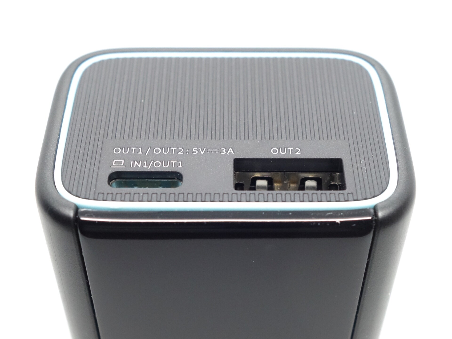

The CUKTECH 10 P Series PB100P is a relatively pocketable power bank with USB-C input/output (90W/120W), USB-A output (33W), a colour display, and a button to control it.
