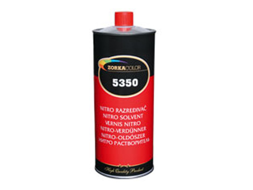

It was me, and i used this
Nothing special, just normal nitro paint thinner.
Also this reply in the HT35 thread might help you.
So do you just apply this solvent with a small paint brush and slice off with an xacto razor knife? Sorry for my ignorance, I just want to know exact steps so I dont ruin the led…
Soak it. Pour some solvent into a glass/jar (covered), let it soak a while, the dome should practically fall off on its own, or you can help it along gently.
Exactly what Lightbringer said, the only difference i did was that i used bigger bowl with boiling water and let the smaller jar with the solvent and the led float in there. Job was done in abot 15 min but i intentionaly let the led sit in there a litle bit longer.
So, de-solder the wires, soak led in Nitro solvent 15 min, gently remove dome? Sounds like a piece of cake. Thanks a lot gentlemen! :+1: :beer:
I would let the solvent do the job without messing with the dome. The nitro is strong solvent and will desolve the dome without problem.
