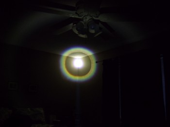

on high in my bedroom… blinding!
exposure turned to –2.0ev… still cant even capture the hot spot with my point and shoot camera
The hot spot has a typical aspheric blue-ish hue, but it definitely is more neutral colored from the de-dome… even better :slight_smile:

Nice mod there,I wanted the x searcher since it came out and now I want it more!I can really tell by the pic just how bright that is,I would love to see some distance shots too.

Not bad. The light is now well-centered than before.
