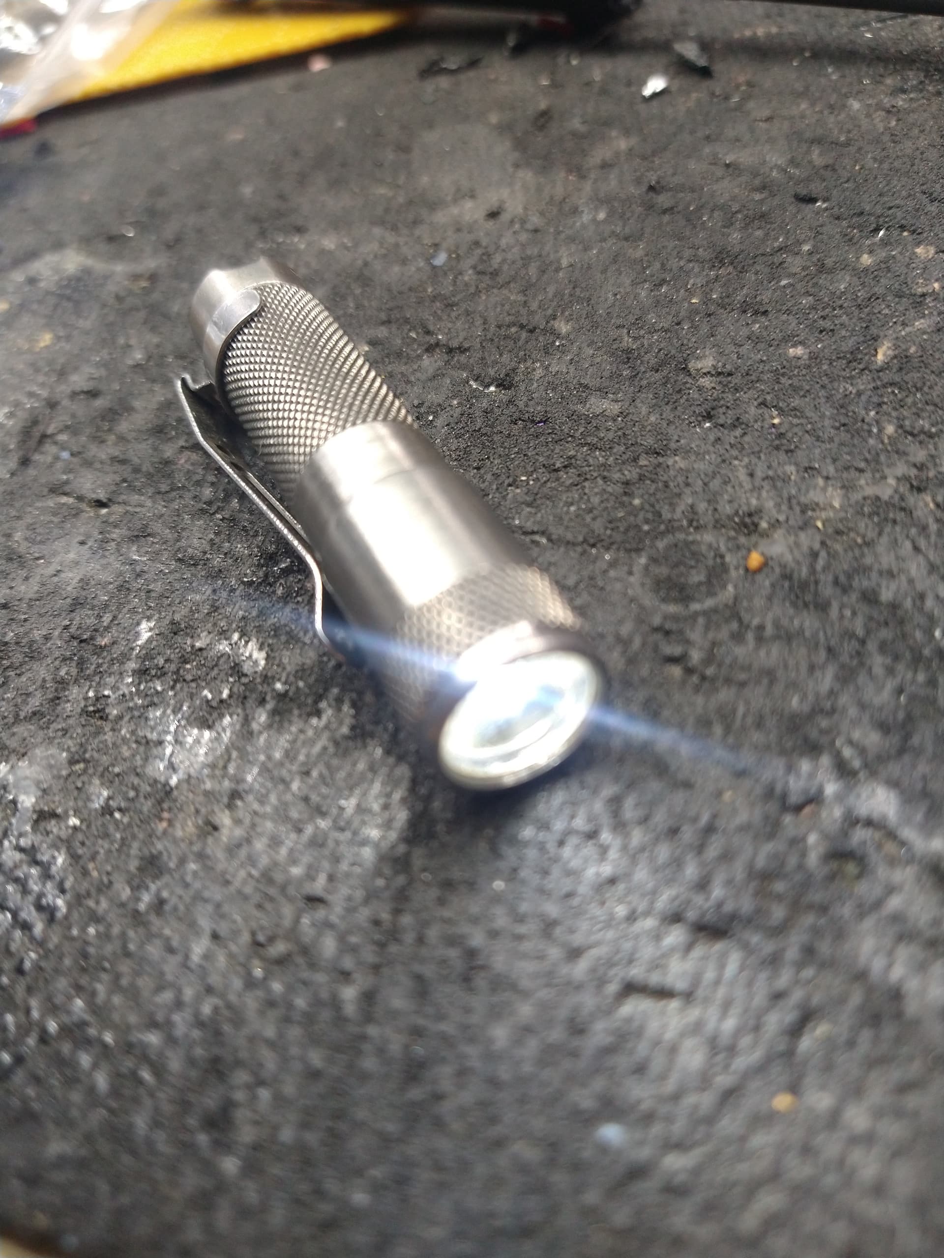

My old DGQ AAA Titanium just stop working… Is any way to contact George to see if he can fixed? Thanks

I am sure you have tried cleaning all the contact points. Mine get kinda wonky sometimes when dirt and debris build up on the ring around the driver or the thin edge of the tube where it makes contact. A good cleaning and new lube on threads get me going again.

Thanks for that tip, I dont try cleaning up, and the contacts and threads, It was just fine, one day I change the battery and stop working. i will clean it tonight…

Thanks Everyone. After a good cleaning is working again…
