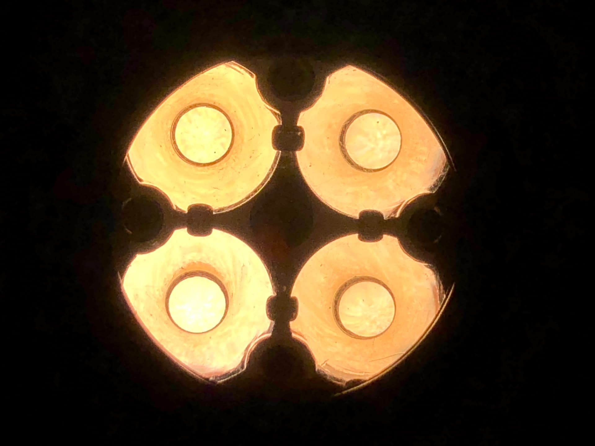

I have problem with led brightness on 0,1% of power is most visible I have 4 diodes 1 works on 100% 2 on ~95% 3 on ~80% and 4 on ~50%
It’s completely normal micro impedance differences or faulty LEDs?
It’s normal if they are all in parallel. There are tiny differences in the forward voltage of the LEDs.

I had the same issue when I reflowed 4 Nichia 219B 2700K LEDs many years ago. They were right next to each other on the LED roll.
It bugged me too much, so I took the 2 that had the same output (on the right side) and put in 2 new 219B 3000K LEDs. It made another great 219B flashlight.

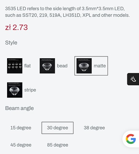

Could you link which TIR you used? I’m very interested!

My lens used is from Convoy I’m not sure I can link model 30° frosted 20mm it’s started to work with me after de dome before was not the best.

Thanks for the info! I’ve always found Convoy’s 3535 single optics to impart a weird tint to the light; on the other hand, Convoy’s 5050 narrow angle optics are perfect to me.
