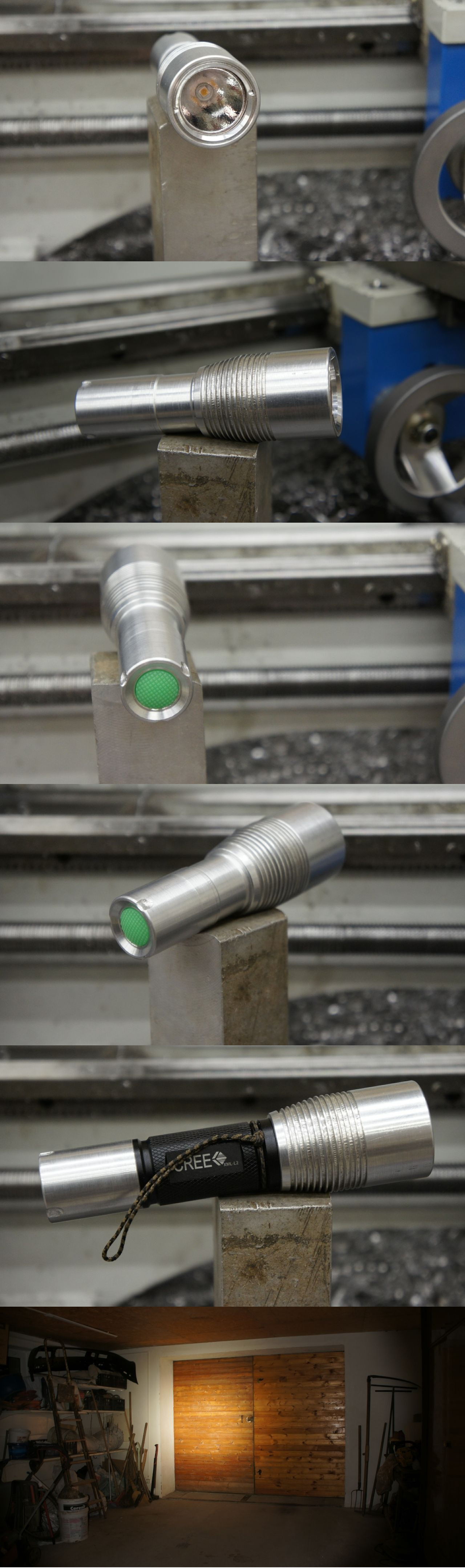

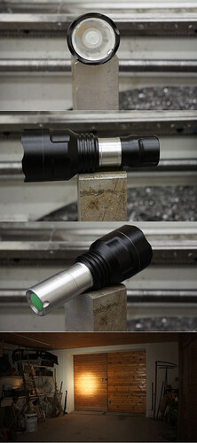

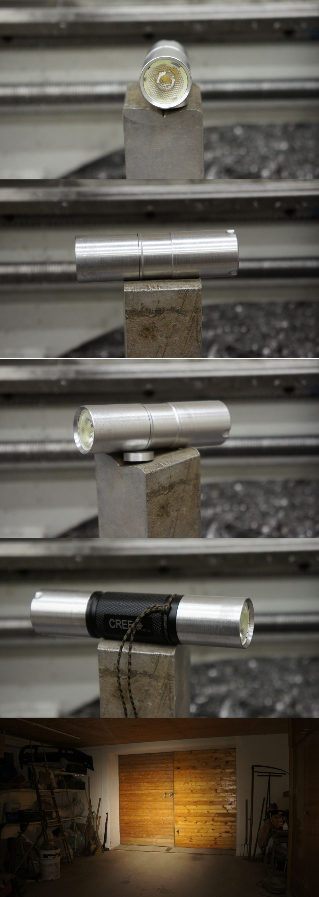

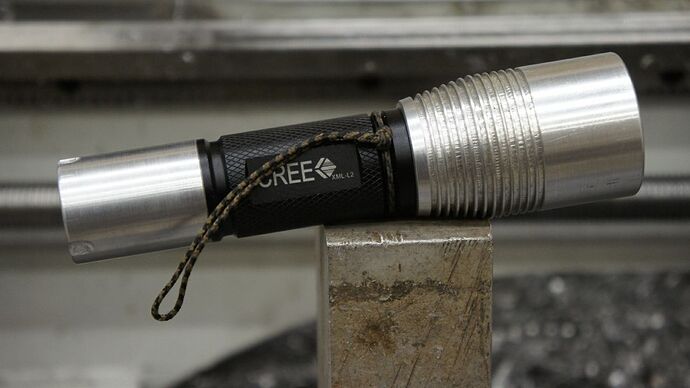

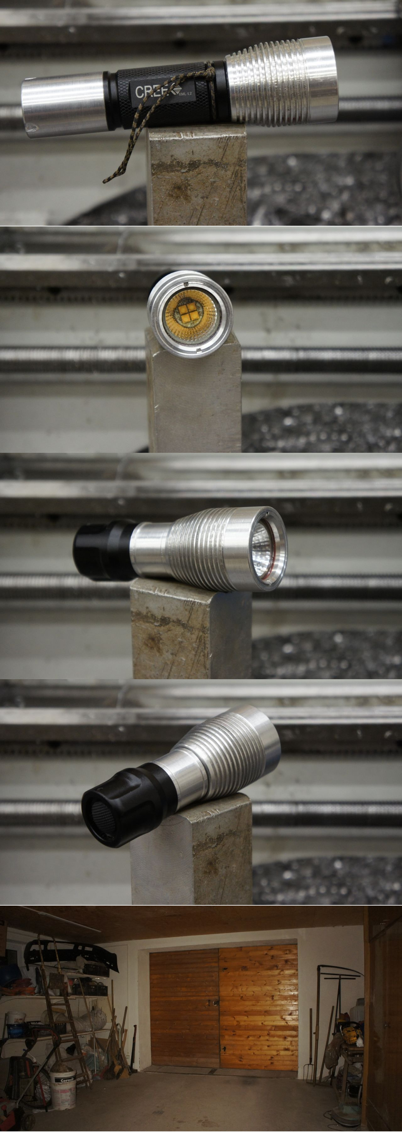

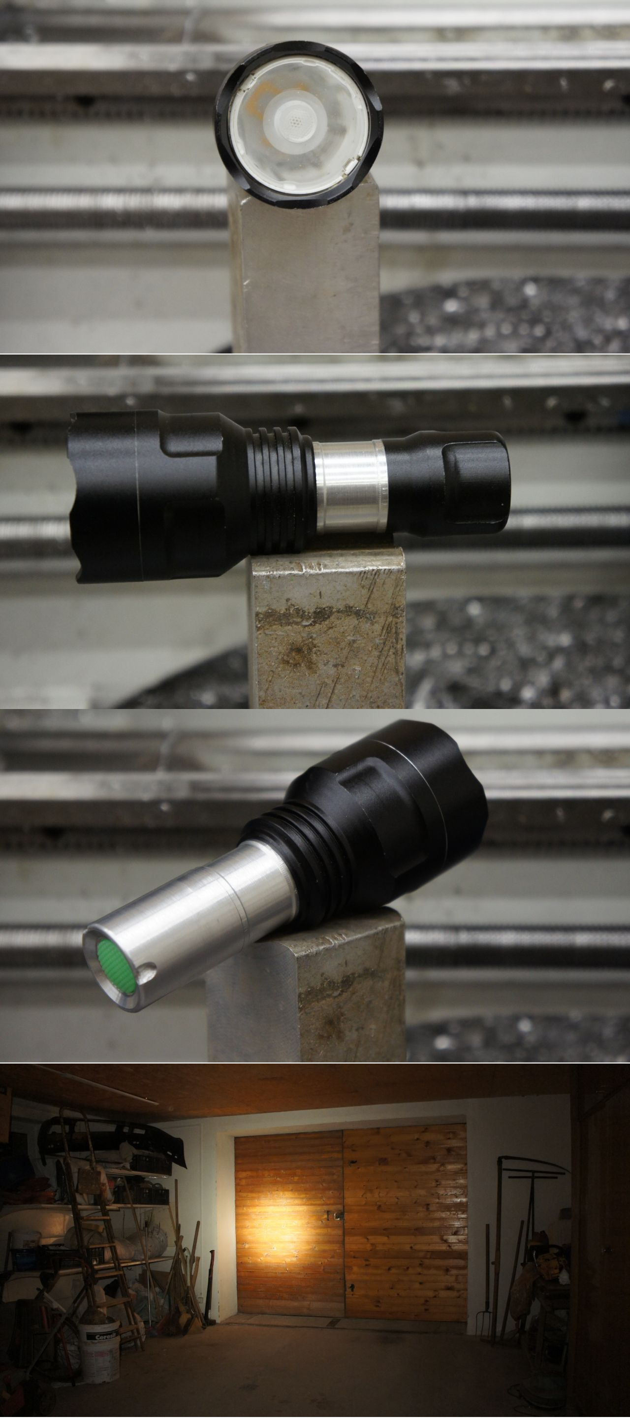

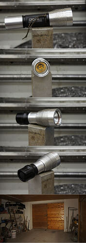

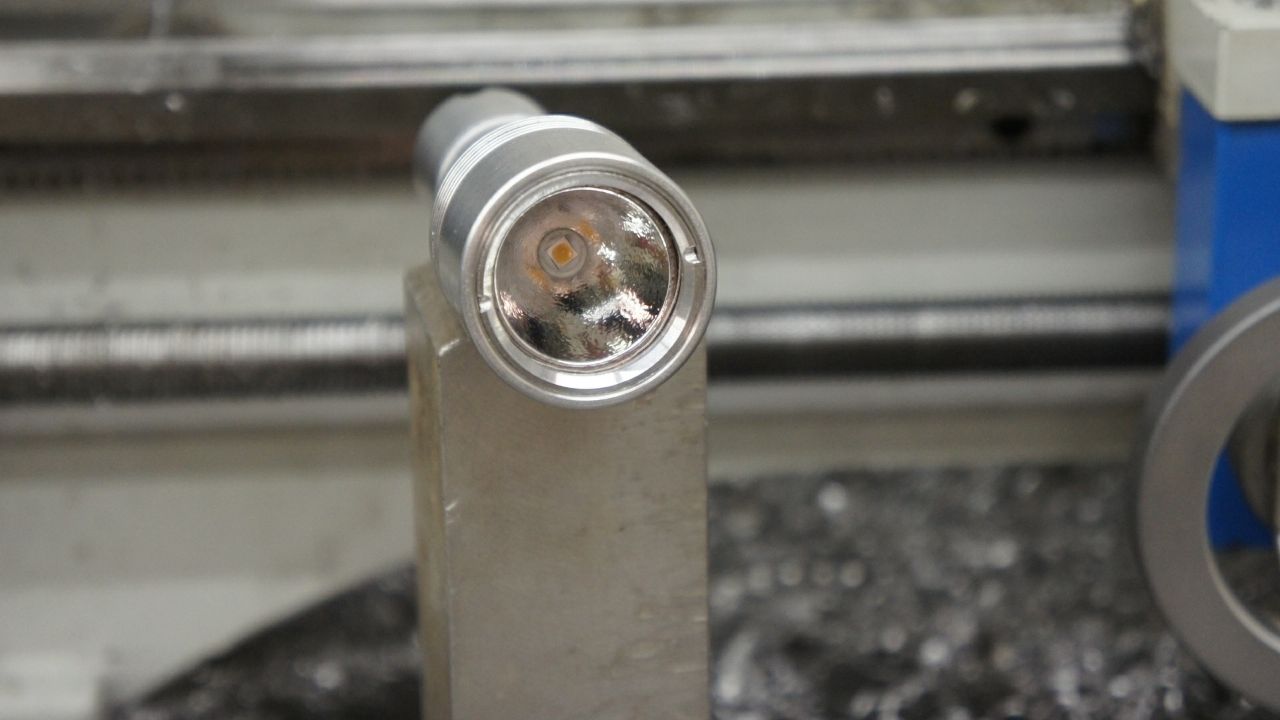

One or maybe four flashlight in lego format. So here we go, one flooder on xt-e 3000K quad mpcb, second is based on p-60 orange pill reflector with cuted tread and NICHIA 519A 3000K in(5A convoy driver), third is head of C8 with 5 degrees TIR and XP-L HI 3000K(6A liner convoy driver), four is simple one mod 7135x3 with “soft” 20 degrees lens and XP-G also 3000K. Beam shots is not best, but they exist. Some photos.
So it can eat 16340/18350/18650
