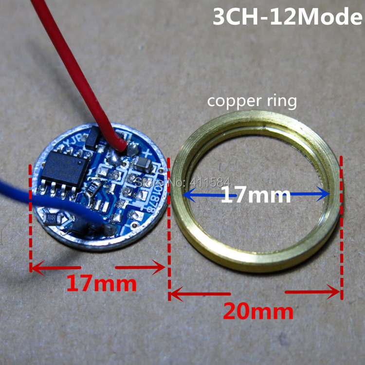

Heres another that may suit your needs. I havent used it so cant comment. It has three goups modes. This is copied from the website.
3 Modes: High (3A) - Medium (900mA) - Low (150mA)
2 Modes: High (3A) - Low (150mA)
1 Mode: High (3A)

Well this has all been a good learning experience so far. Thanks for the input. I see now that there are two separate components involved, sometimes combined into one piece and sometimes not. The contact plate and the PCB. I am wondering if a 21mm contact plate will work in the 22mm seat. I am concerned that a 20.5mn contact plate would be to small to sit on the small ledge machined into the pill. I found this which might fit OK but I am not sure how I would connect it to a PCB. Maybe this would be the ticket. It has a 21mm contact plate.
