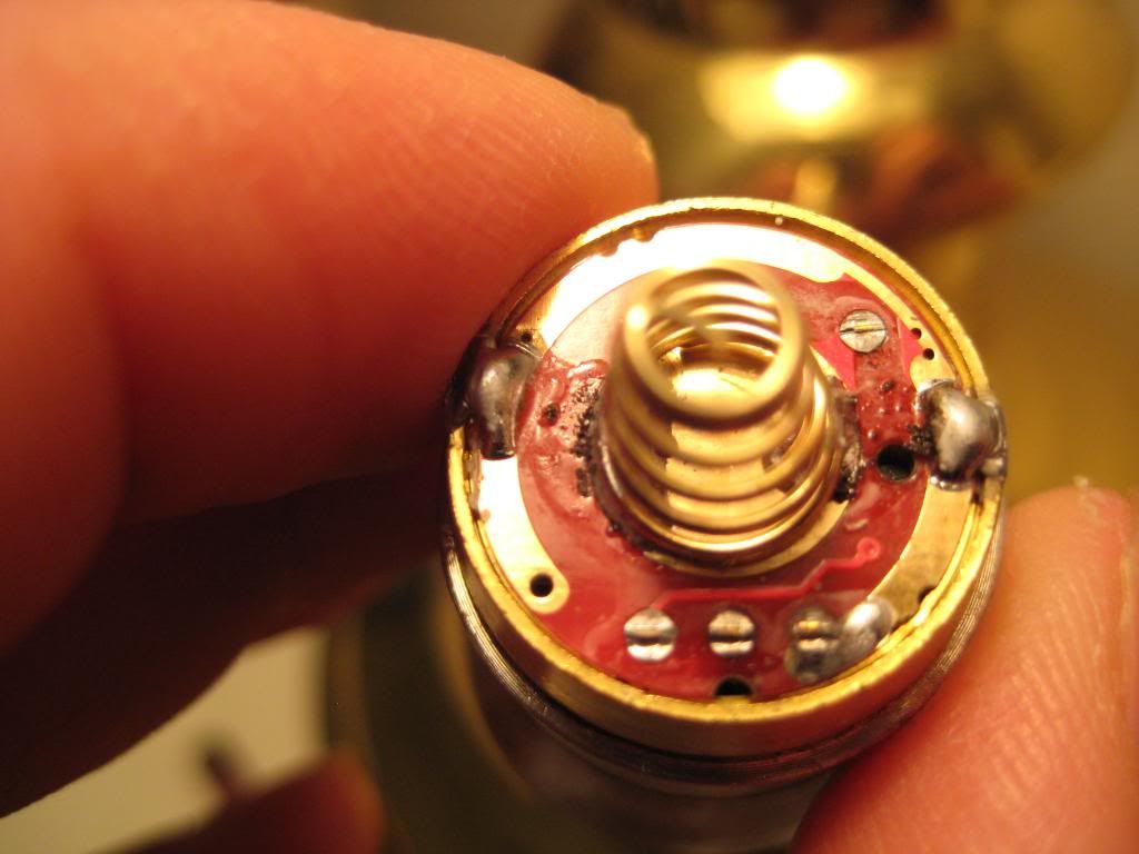

I have this drop-in. Its an XPG R5 5 mode but you will be shocked to hear that I HATE BLINKY MODES! But when I looked at it, it has three bits a bit like the stars you get on other drop-in that can be soldered in a certain way to change the modes.
So can I do this with mine?

Yeah, iv’e just spent ages doing the photobucket thing but it has not worked.
Try that Garry. :slight_smile:

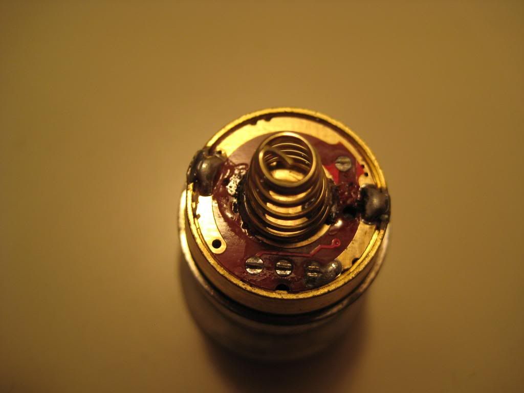

Marc.
Another one :slight_smile:
I don’t recognise the board but I’d certainly try bridging those to see what happens.
Just don’t blame me if it lets out the magic blue smoke.

Those aren’t stars those are “leads” to the top side board. That’s a 2 piece board.
Yeah, I know they are not stars, I just didn’t know how to explain them. It’s just with the last one being connected I thought they might work in a similar way.
Marc.
Don’t try to short any of those contacts or you’ll ruin the driver. Those are “leads” as stated above one of which is positive one negative an one most likely PWM. You could swap the driver for any other driver that will fit and have modes you want.
