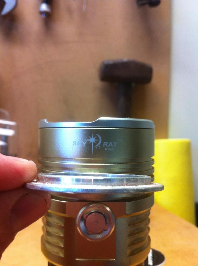

both of these fogged/smoked up.
one had 2 leds going blue from overheating.
other seemed ok till it simply died.
these dont thread into the housing like my old securitylng.
i suspect lack of thermal path to the body.
looks like the emitter plate is TAPED to the reflector!
lets see how seller handles this.

I got the 5 xml-2 from gearbest, apparently all the skyray kings will be like that, no originals left
Now ive got a relatively cheap skyray king host

emitter plate threaded to body?
I had the same problem - no cooling at all on my SRK, i had to build my own. The best i could find is This
