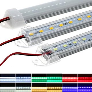

A few years ago I posted here about lighting a two car garage on the cheap using seven 50cm (20") 12V DC bar lights and a 60W converter. Each bar has 36 SMD 5730 LEDs and are evenly spaced around the garage ceiling. Yes, they are very efficient and bright. I looked to see if I could still get them on eBay these days and they are available from China. A package of 5 will cost you around $14 with shipping, tariff included. 5pcs/lot 50CM U Aluminium shell DC 12V 36 SMD 5630 LED Hard Rigid LED Strip Bar | eBay The seven strips don’t come close to using 60W. Picture here bar light — Postimages
