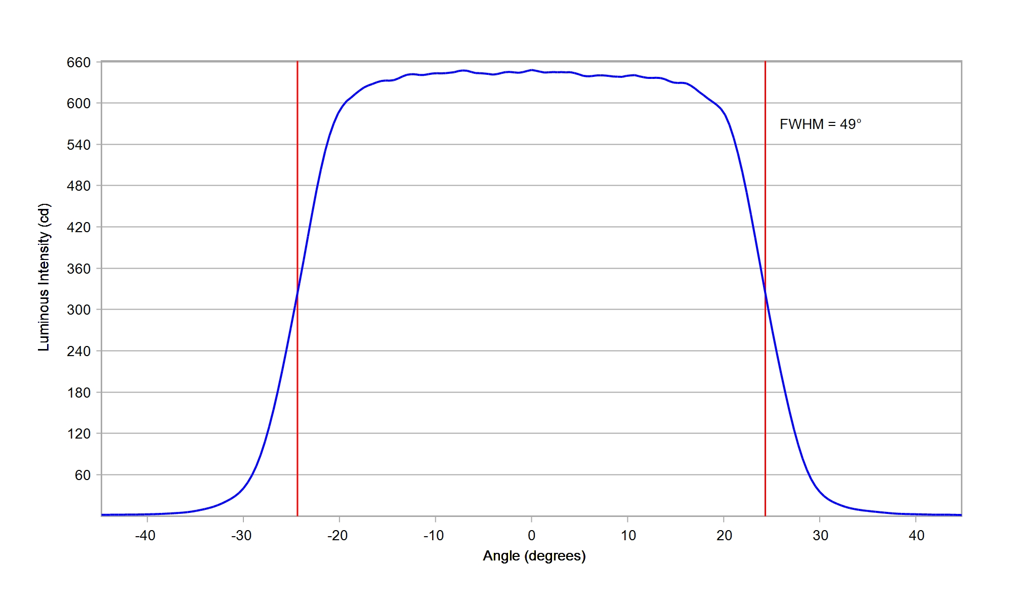

To illustrate an ‘ideal’ lens+LED combo:
- Carclo 10049 driven by a small, ‘trowy’ emitter (horizontal plot):

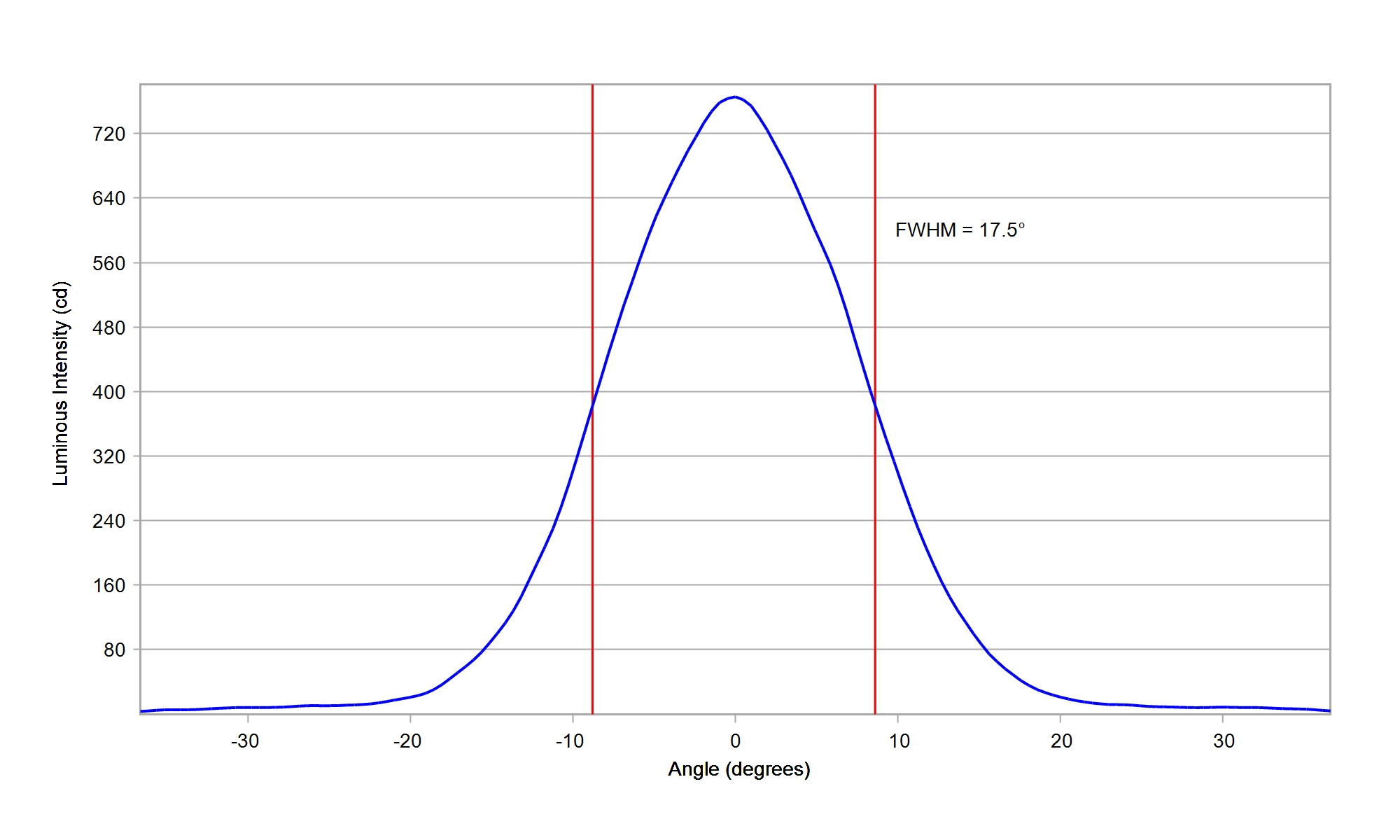

- Same Carclo driven by a large, floody emitter (vertical plot):
Getting a nice balance with a single emitter is ‘fun’. But seems like a large, floody emitter makes the horizontal pattern only a little bit worse - by introducing a slight falloff with angle.
Notice broad, constant horizontal ‘coverage’ with a nice, wide plateau and a nice constant falloff w. angle in the vertical. Vertical could be still too steep for use-case, jostling around causes too sudden changes in light output if the hotspot is not precisely aimed at the distance. A 20-30deg vertical pattern could be better suited.
Sadly Carclo (also LEDIL and other major TIR lens manufacturers) makes only one type of polar-pattern elliptical lens (45 by 10/15 deg, depending on LED). Everything else is a custom manufacture. Luckily Aliexpress is full of ‘interesting’ TIR optics, mostly in 20mm-23mm size.
I see! For the sort of uniform plateau beam profile with a smooth fall-off, I find that beaded TIR optics do a great job.
I current have a SFT40 running a 20mm “20 deg” optic; I assume that the 20deg is radial angle, since I measured that the beam cone has a diametrical angle around 40 degrees. It produces a nice large circle (a bit hexagonal due to the beading being a hexagonal lattice) of uniform illumination, though the falloff is a bit fast.
I would try Convoy’s 5050 TIRs in 20mm and 21mm, and try some beaded options with at least 20 degree angle. One of them might work great for you.
