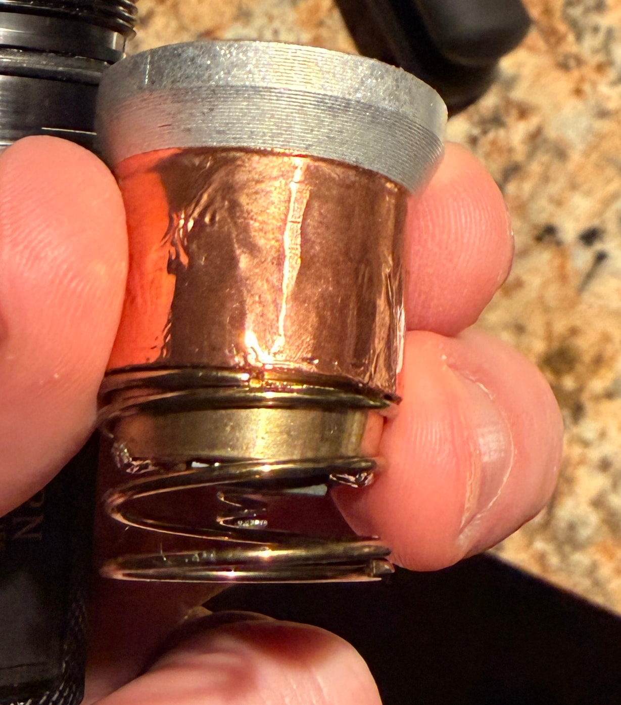

Hope this is the right spot, recently acquired a great condition Solarforce L2N and the seller wasn’t sure what emitter/ driver is in it. Looks like a P60 drop in but there’s no marking on the housing. Taking a guess the emitter is close to a Cree XM-L2 6500k ish. Hoping someone on here may be able to help identify it!

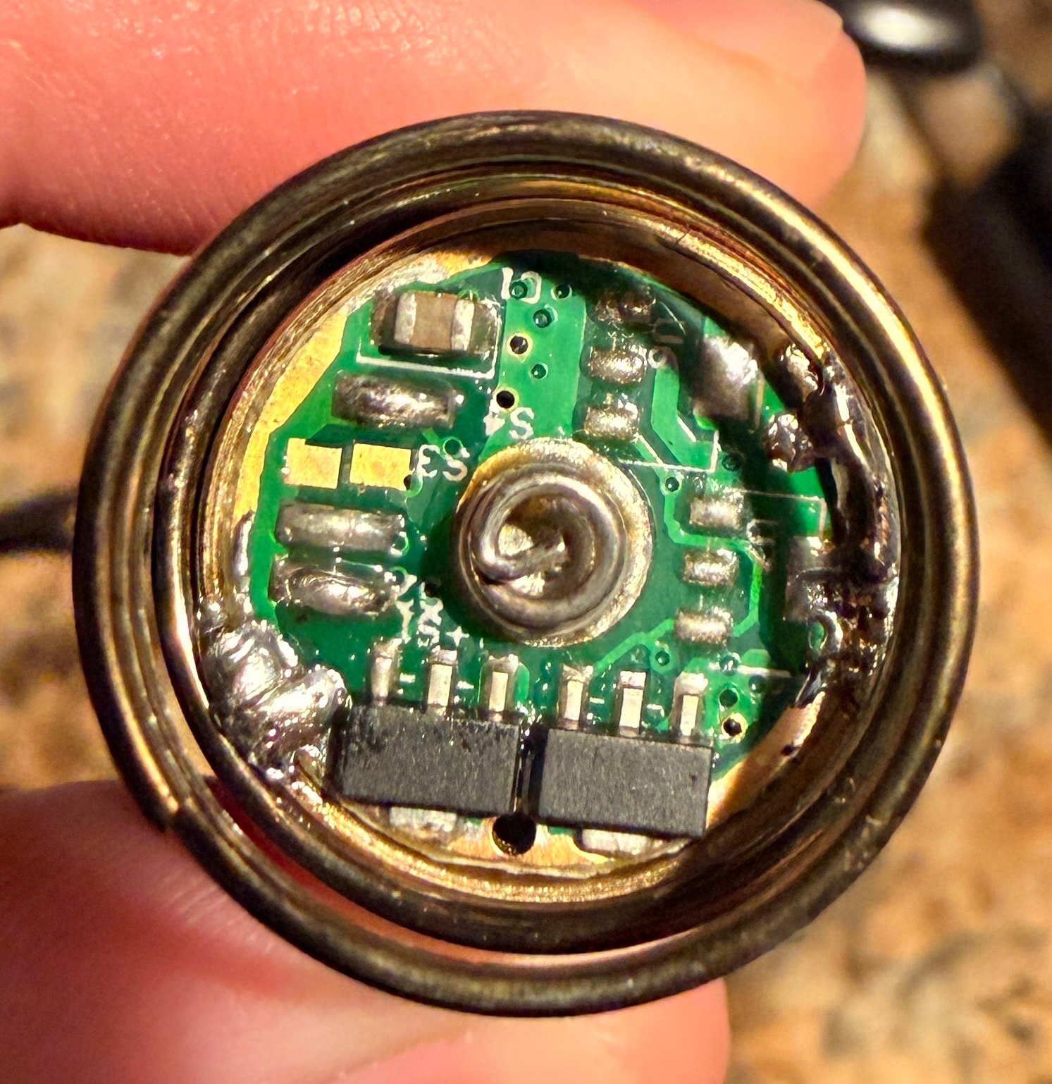

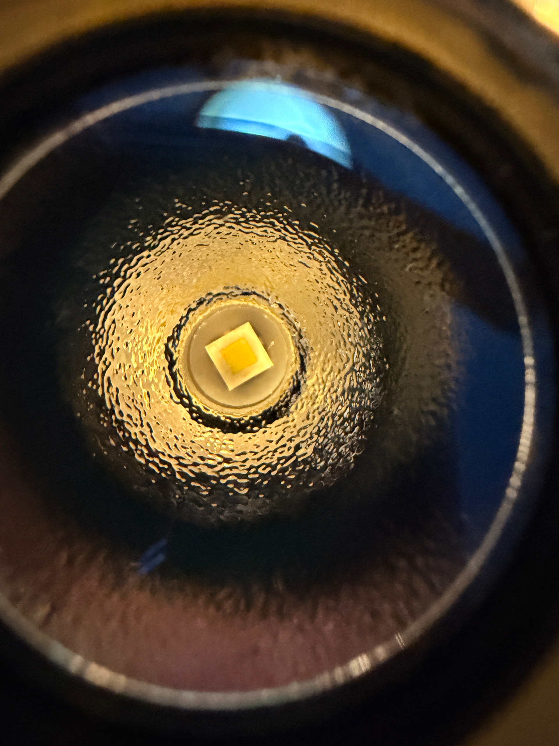

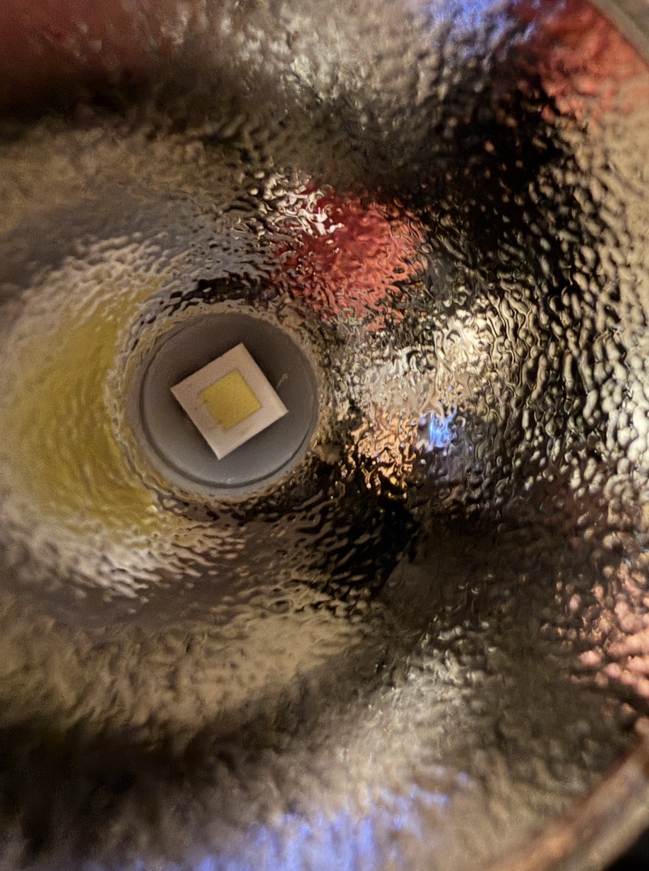

Led is 1st gen xhp 35 hi, the driver is some sort of 3V linear with amc7135 chips. Hard to tell exactly without the other side of the driver.
I was under impression all the 1st gen XHP-35 HI were 12V?
It’s kinda hard to see from the photos, it’s not an XP-L Hi, is it?
Yeah, it’s XP-L! Good catch. Don’t know what I was thinking :person_facepalming::rofl:
Awesome! Thank you so much! I’ll try and get some time this weekend to pull the reflector off and get some pictures of the driver
Plenty of options to change it if you wanted different modes etc, IIRC these dropin modules use 17mm drivers, personally I’d not try pushing it too hard as the thermals of P60 drop-ins are not as good as “integrated shelf” type designs. Perhaps the convoy 3V 5A buck might fit?
Not a bad idea! Yeah whatever the current driver is allows for 3 modes that seem like a 10,30,100 for brightness. Not planning on this light to be a show stopper with performance but not a big fan of the 6500k color. Easy route would be a drop in like Malkoff or Lumensfactory but I may do a custom route, the Convoy idea is a good one!

It is an XPL-HI 3V 3A probably 6500K
It’s a good catch and you can add 7135 chip to increase power
