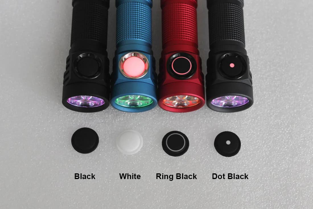

The “dot” button type is the best for RGB, the mix looks quite good in the middle.
If you want to use the ring or white type choose single color aux.
Another difference is that only the single color button aux is on while the main emitter is on, RGB button is off while the main emitter is on.
I personally prefer red aux, they are the least disturbing in the dark.
These RGB mixed colors look good only when the aux is set to high brightness. On low brightness setting the blue and green parts of the RGB are much more brighter than the red part.
Amber single color aux is amber even on low brightness.
@AccurateJazz Thanks! Sounds like I will largely want to stick with single color button lights because I want the flexibility to swap between button styles. Also, the lack of good low mode for RGB is pretty unfortunate
And the pink goes all lavendery on low…
