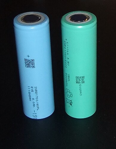

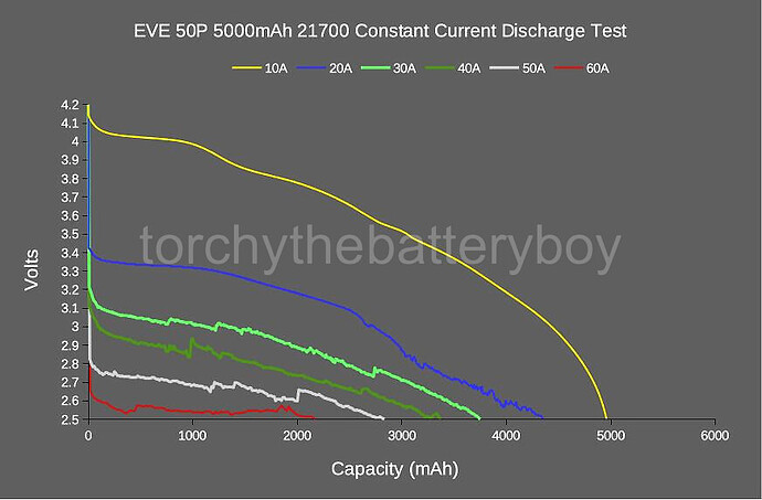

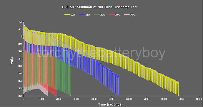

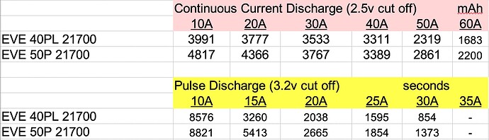

I was well impressed with the 4000mAh EVE 40PL 21700 so I thought I would check the 5000mAh 50P 21700 to see how it compared. I wasn’t expecting the 50P to be a match for the 40PL at higher currents, but the opposite was the case with the 50P out performing the 40PL at everytest point. It also stayed cooler up to 40A, reaching a maximum temperature of 70.4°C at 60A continuous current.
That appears to be a 50PL not 50P. Which is also tabless and newer, so not really a surprise it outperforms the 40PL.
