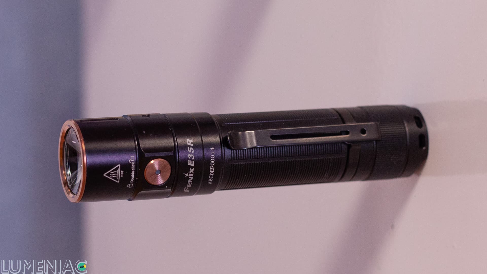

Fenix E35R is just 2mm longer then the previous model. That is minor difference as well as other ones pic. The only real difference for me is built-in charge.
The size of Fenix E35R is quite usual for a 21700 powered flashlight. 12 cm length means that this flashlight is quite comfortable for both your pocket and your hand.

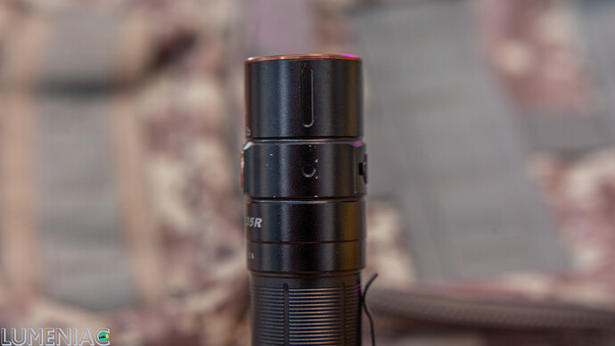

Magnet in the tail of the flashlight easily holds it horizontally with a battery inside.

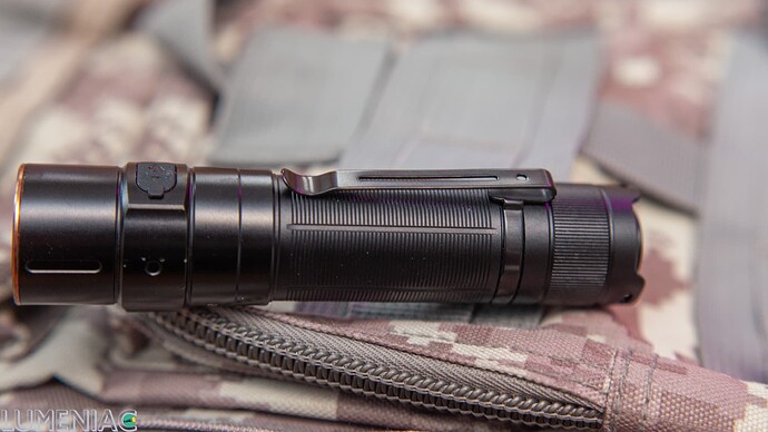

The clip is not tight, so you can remove and put back it without scratching anodizing. Not that I was embarrassed that the clip is one-sided, but is it difficult to machine an additional seat for the clip near the head?
The flashlight has a comfortable grip, but the knurling is very smooth and not tenacious at all. Two-sided clip would help here, actually. Or adding a little bit to tail diameter to form sort of saddle.
As i expected, there is just only one spring at the tail cap.
Machining is perfect as usually for Fenix, threads are well lubricated.

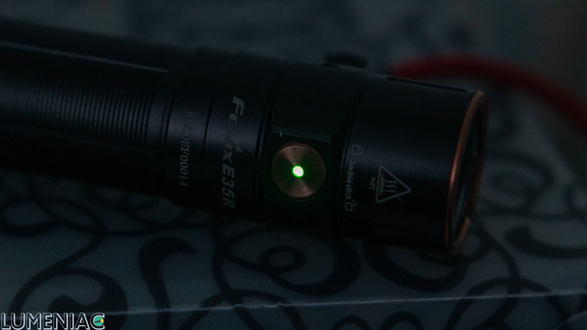

The button is flat and small. But it is easy to find due to the fact that it is located on top of a flat area. There is the usual red-green charging indicator. I also I like the color of the button and bezel, a good design decision.

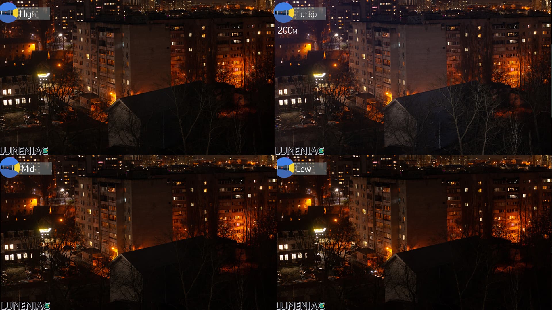

What about light - wide and dim sidelight, wide and bright hotpot
720_dom
720_da4a
720_da4a_2
720_road
as you can see, chances are low that will ned to climb abopve even Mid mode in ordinary needs.
what about throw, i confirm that Fenix E35R will enable you to illuminate things at 200m. That is really good for EDC flashlight. In turbo mode, of course.
