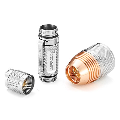

Mildlyangryjohnny:
Not that exact tr20 thingy— that looks like a ginormous 26650 thrower. But borrow some of the millwork concept, thin fins 1/16(1.6mm) or so thick, spaced the same on a ~1.5+ inch head they couldnt be very deep maybe 3/16”, or so. Yeah, and do it in copper. There was an astrolux i remember seeing a few years back— sc ? Maybe a bit like that form factor wise but slightly deeper on the fin milling. But narrow 1/16” fins and spacing. This, as opposed to the e07 cad drawing with 3 fins at approx 3/16 - 1/4” thick.
You’re probably thinking about the BLF X6 / Astrolux SS. The fins are very shallow though. That thing is a beauty and a true heavy weight. I actually have both the BLF X6 and Astrolux SS. Without batteries, the X6 weighs 371.4g. Just the copper pill without the top bezzel already weighs 196.6g. The massive copper pill allows it to handle turbo like a champ. I just took some measurements out of curiousity:
1s: 1,271 lm
30s: 1,254 lm
60s: 1,250 lm
90s: 1,241 lm
120s: 1,232 lm
At 2 min., the copper is warm but the stainless steel remains cool, which is unfortunate. SS has very poor heat conductivity so the heat is almost entirely absorbed by the copper pill and due to the limited surface area of the pill to radiate heat, it takes a long time for it to cool. If the SS parts were aluminum, they can be used for heat shedding and performance should be much better.
If FF decides to make a copper head version of E07 with aluminum body, I will definitely buy it. Should be a solid performer for long steady turbos or any output levels for that matter.
SKV89:
Mildlyangryjohnny:
1s: 1,271 lm
30s: 1,254 lm
60s: 1,250 lm
90s: 1,241 lm
120s: 1,232 lm
Yup. Thats the one. Almost pulled the trigger on that one but didnt.
Frankly, i dont care about weight unless it is on my keychain. Size matters for this—for me, weight is hardly a concern. Lets put it this way if weight is the tradeoff for extended runtimes then it seems like a nobrainer to me, all things considered highpowered led flashlights are still in their infancy if we cant run a torch on high power for more than a minute. We—flashlight consumers/addicts have grown to accept this anomolous reality, because its all we have known. I submit that runtime trumps weight for this particular unit. i dont really want to go with the zebralight 700/21700 offering so i hope this conversation gets heard by ff. They could make something truly special.
And i will still end up getting the zebralight 700 thingy if Just to keep my new 21700s warm.

That was a really nice item. It’s also the reason why Bistro’s thermal code doesn’t work on smaller lights — it was designed and calibrated for something with a big solid heat sink, so it responds too slowly on lights with a higher power-to-mass ratio. To put it another way, the massive heat sink made it so the thermal algorithm could be pretty bad and still work. But smaller lights require a smarter algorithm.
I must admit I don’t really use my X5 or X6 any more, because both were kind of obsoleted by the Emisar D1 / D1S. But they’re still very nice, and I keep mine out on display with their nice wooden case along with the other items I helped make. It’s kind of nice having a physical remnant of projects past, something to look at as a reminder.
Weight definitely matters though. Carrying the steel/copper X6 was like carrying a brick. It’s very pretty, and performs well, but if I wanted to actually carry one around I used the aluminum version instead. Even if I had it in my purse, with the steel version, it would make my shoulder sore after a while. Granted, I have all sorts of other toys in there too; there’s a reason they call me ToyKeeper. But still, the weight was a big drawback for practical purposes.
ToyKeeper:
Understood. However, this seems to support what skv89 has been proposing about mass. Plus, more fins, plus copper. He suggested 40g of extra mass. There was some discussion about whether this would have any effect. Based on what you have observed it seems that it does have quantifiable effect on runtime. In addition, pairing a beefier aluminum head or as i have proposed—copper. I think the original impetus for me to engage was that the e07 fins seem a bit ill suited. Many of the original comments were “thats a lot of light in a small package”. The astrolux came up because i had a vague memory of a copper head with many thin fins. I think a stainless battery compartment isnt appropriate. Throw a weightier multi finned head on an aluminum body i think is where my vote would go. Kind of a bridge between ideas, not a full on copy of the astrolux or trj20.
But honestly we’re all just fussing on about things that are probably just dreamy kids stuff. Fireflies asked what this community thought and i want awesome to happen—it seems to me theyre on pace for awesome. It seems to me like there is some growing enthusiasm for this fledgling little outfit.
And just imagine a big heatsink with an efficient driver/firmware thingy—which is to say thermal algorithm. Wow.
