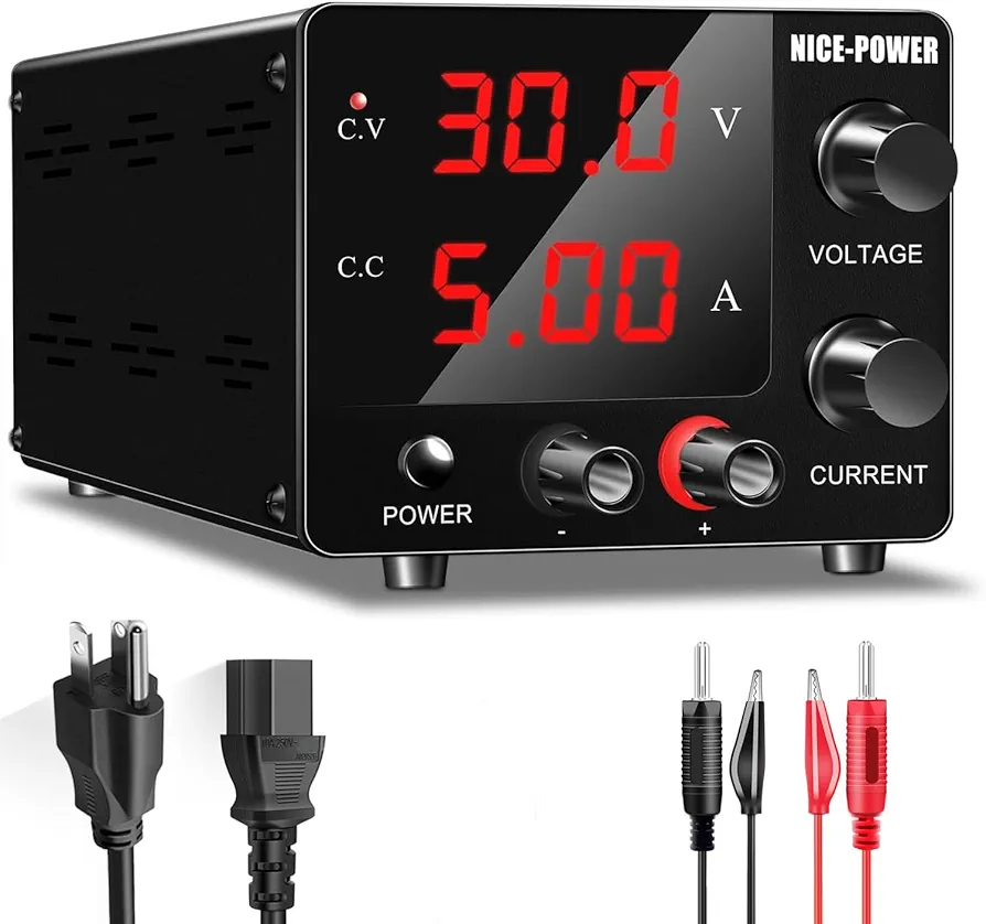

Been using this one as a barebones supply and it’s fine for what I now use it for. Looks comparatively decent on a o-scope and my needs aren’t super critical anymore .
NICE-POWER DC Power Supply Variable, 30V 5A Adjustable Switching Regulated Power Supply with Encoder
