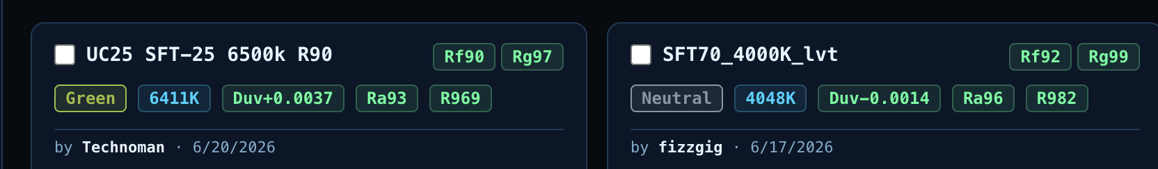

Nitpicking question: for the away-from-zero warning colour-coding of the Duv button on cards, is the threshold ±0.006 for going from green to orange? Does it ever turn red?
p.s. The neutral/green/rosy indicator uses ±0.002 threshold, I figured?
