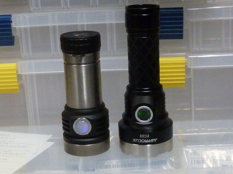

Here's the EC03 next to my other favorite XHP50.2 triple, the X9:

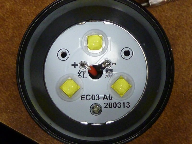

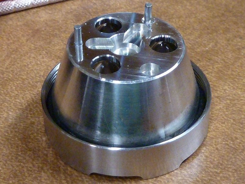

Got a surprise here - no screw inside the pill as I thought there would be. Don't think I've seen a multi-LED reflector setup like this before, but I like it. No screw inside the pill like a Q8, one screw holding it down and 2 alignment holes for pins on the reflector. So the MCPCB is kept down tight (should anyways), and no problem twisting the reflector. Also I like the machined cutouts for the screw head and wiring connections - I used to do that machining myself on Shocker reflectors.
So the LED wires are short which is good, but probably a little too thin for all those amps. Think they are 22 AWG, might be 20, but figure 1 step up should help.

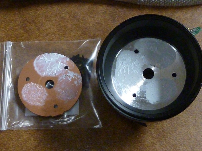

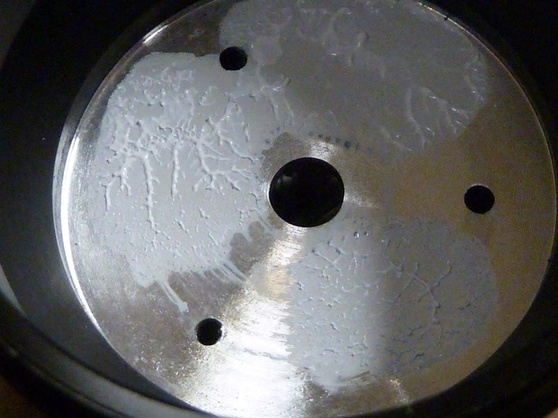

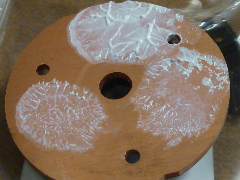

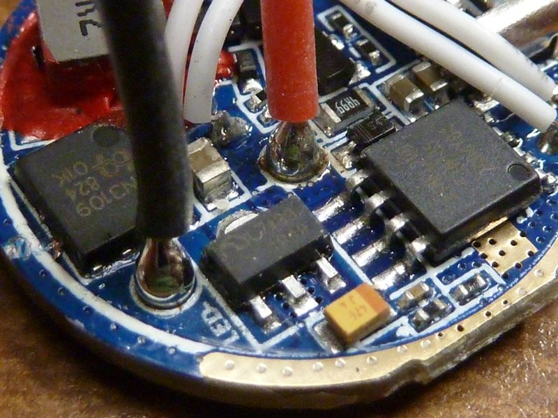

They were a little short on the grease, could be better, probably doesn't have much effect:
The LED wires are 20 AWG, MCPCB is 1.5 mm thick - wish they would make them thicker - lot of amps and heat here:

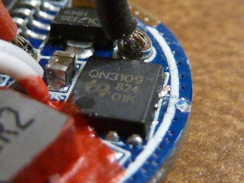

Standard FET+1 components, not sure what FET this is:
I'd upgrade the wires to 18 AWG, and may add some solder to the driver ring, where it makes contact to the battery tube - not sure if it's making good contact there. Should upgrade Anduril while I got it open.
Also I'll sand the MCPCB and shelf surfaces, use MX4.

Found the datasheet on the QN3109 FET here: http://j5d2v7d7.stackpathcdn.com/wp-content/uploads/2019/04/QN3109.pdf
My preferred FET, the SIRA20DP, datasheet here: https://www.vishay.com/docs/76212/sira20dp.pdf
There are 2 primary things I look at: Continuous/Pulsed drain current (bigger is better) and RDSON (smaller is better). The QN3109 isn't bad but still think the SIRA20DP is better. The SIRA20DP, I feel, is either the best or one of the best of that family of FET's. We started with the SIR800DP a few years back, then discovered the better SIR404DP, and experimented with a couple others.
The Infineon bsc009ne2ls5atma1 is also up there: https://www.infineon.com/dgdl/Infineon-BSC009NE2LS5-DS-v02_00-EN.pdf?fileId=5546d4624bcaebcf014c096c7c152310
Still, my overall preference is the SIRA20DP.
I would do a tailcap spring bypass, maybe add light layer of NO-OX-ID on the battery tube to driver contact.
Reflector is standard block of alum with typical coating - nothing different here.
