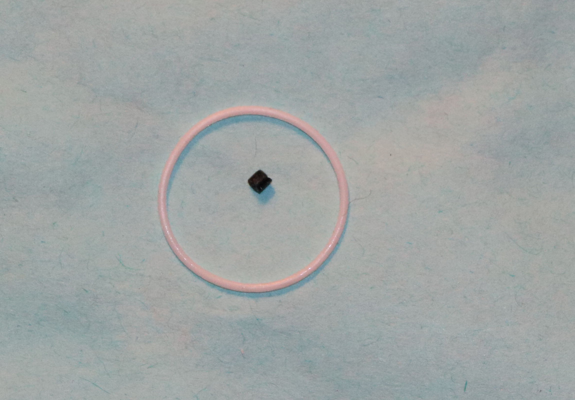

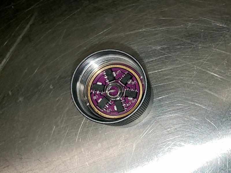

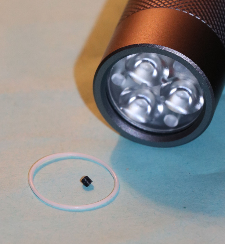

- While I had the head off I noticed one of the chips had a wart. That is odd. Using tweezers I removed it. It looks like a nubbin from the tail switch. Time to check the tail.
- With the head pointing to the ceiling and the tail on the table, remove the body tube from the tail. Remove the switch. - the nubbin is there. Looks like I have an extra nubbin.
- Since I have the tail off I decide to remove the clip. I generally don't keep clips on my lights. Hmmm, between the clip and the body tube is a white o-ring. Oh, that is suppose to be around the inner tube. Edit: it should be there. see posts below.
- Remove the inner tube there is the white o-ring. Looks like I have an extra o-ring too.

Because it sometimes automatically ramp, another possibility is that the switch always makes contact, not just when you click it. You can check that by trying to use the light as a twisty: see if you can get the UI working by tightening/loosing the head instead of clicking the switch. If it does that, the switch is always āonā. (the switch plate may be soldered crooked, bridging the outer and inner ring on the tail PCB)

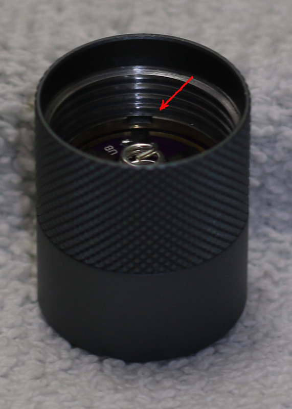

I find the notches easier to see from an angle rather than looking straight down at the driver. (Hope it shows up in this picture. There is some glare.)
Yeah, the white O-ring by the clip is there to keep the clip from spinning freely. Itās not for the inner tube.
Something else which might help is to take out the driver retaining ring entirely, wiggle the driver around to make sure it goes into the slot itās meant to be in, and then tighten the ring again. One edge of the driver is flat, so it can only go in one direction. Be careful not to twist the wires off though. Without de-soldering the wires, the driver can only move a little bit.

Good idea. I previously tightened the driver retaining ring, but I didnāt think to check that the flat spot on the driver was aligned with the tube.
Re: white o-ring. My first thought was that it was to keep the clip tight. But then I noted in CRXās review that the o-ring was around the inner tube.
It seems I have a white o-ring around my inner tube too and between the clip and the body.
Yes, there are two white O-rings⦠one to separate the inner tube from the outer tube, and one to provide friction for the clip.

- Per TKās suggestion, I removed the driver retaining ring. The driver appeared to be seated correctly with the notch. I tired to remove the driver but couldnāt. I didnāt want to risk deforming the spring by pulling too hard. I used a little stick (the ones I steal from my wife. Orange stick?) to press down on the driver and make sure it was down all the way around.
