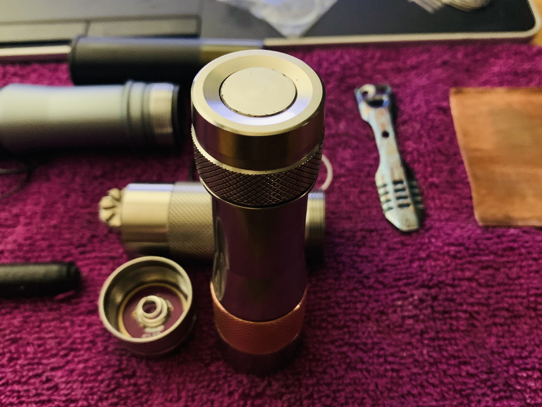

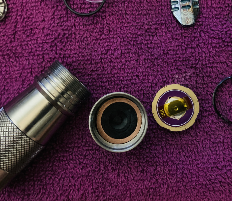

It is just a copper sealing ring that I pounded flat to fit the switch pcb. It ended up being 1mm thick. I packed the button/cap with NO-OX-ID because it jiggled a little, to dampen it. Works with or with out retainer ring…
It works in the Ti/Cu very well also…
