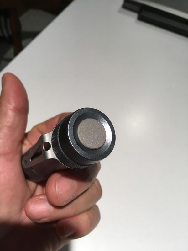

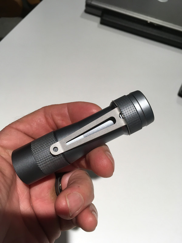

Not much of a Mod—- I changed out the XPL-1A to Samsung 4k —- Very nice tint now — Surprising the Lumintop Optic works well with these LEDs— Seems to be more Floody with less artifacts — I have the same LEDs in a S2+ with the 511 optic to compare
I also had to get rid of that shiny clip from the Vipon buy light — I bead blasted the Clip and Button (better) — I’m thinking about Blueing the clip but the button is aluminum so that’s a no go—- I like the Heated look also
It isn’t, it’s steel, if they didn’t change that. Otherwise TeeDubya couldn’t have etched it.

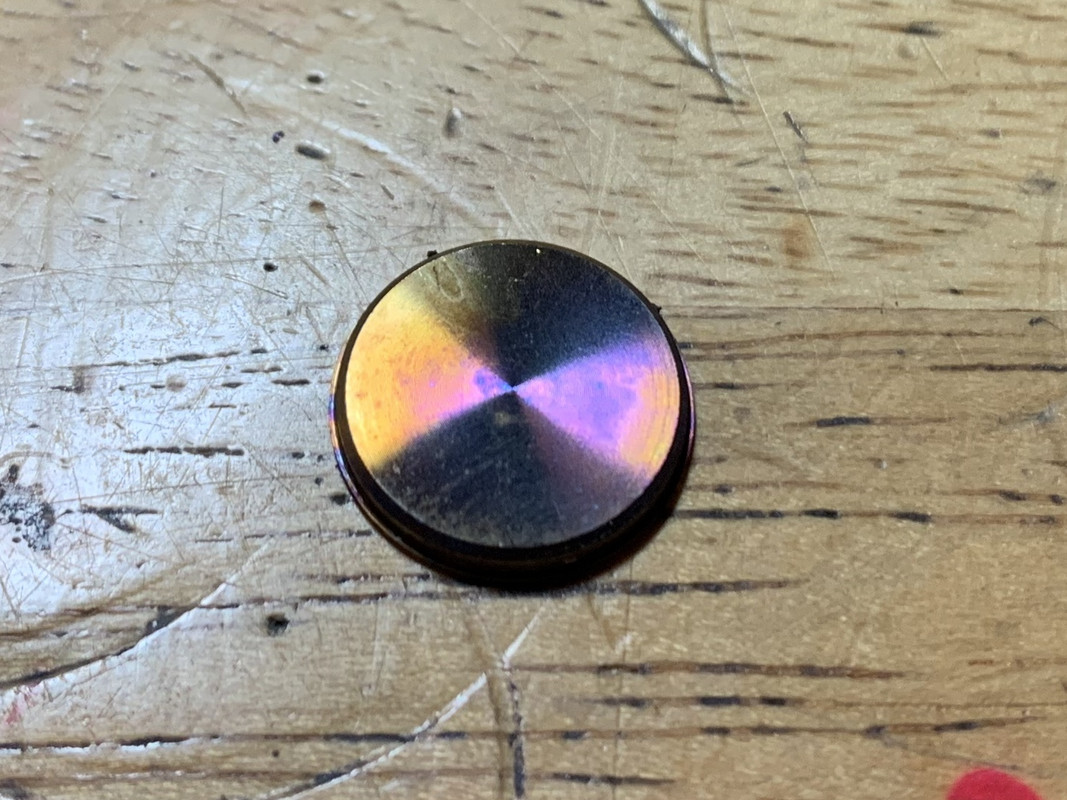

The button is stainless steel and can be colored with heat….so can the clip…
Ok good to know—- I just checked the clip is magnetic —- KawiBoy1428 what clip is that
The original black clip….bead blasted and heated with a oxy/acetylene torch….
