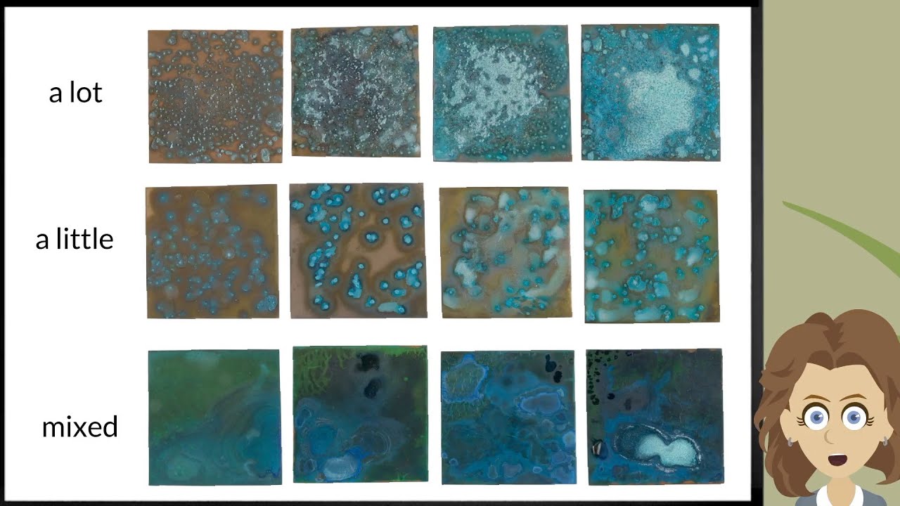

After watching some videos on youtube for jewellery patinas, I came across this robot voiced, but very thorough set of video tests, there are several more but this one is definitely worth a watch.
So I am using ammonia, white vinegar, soy sauce and salt.
