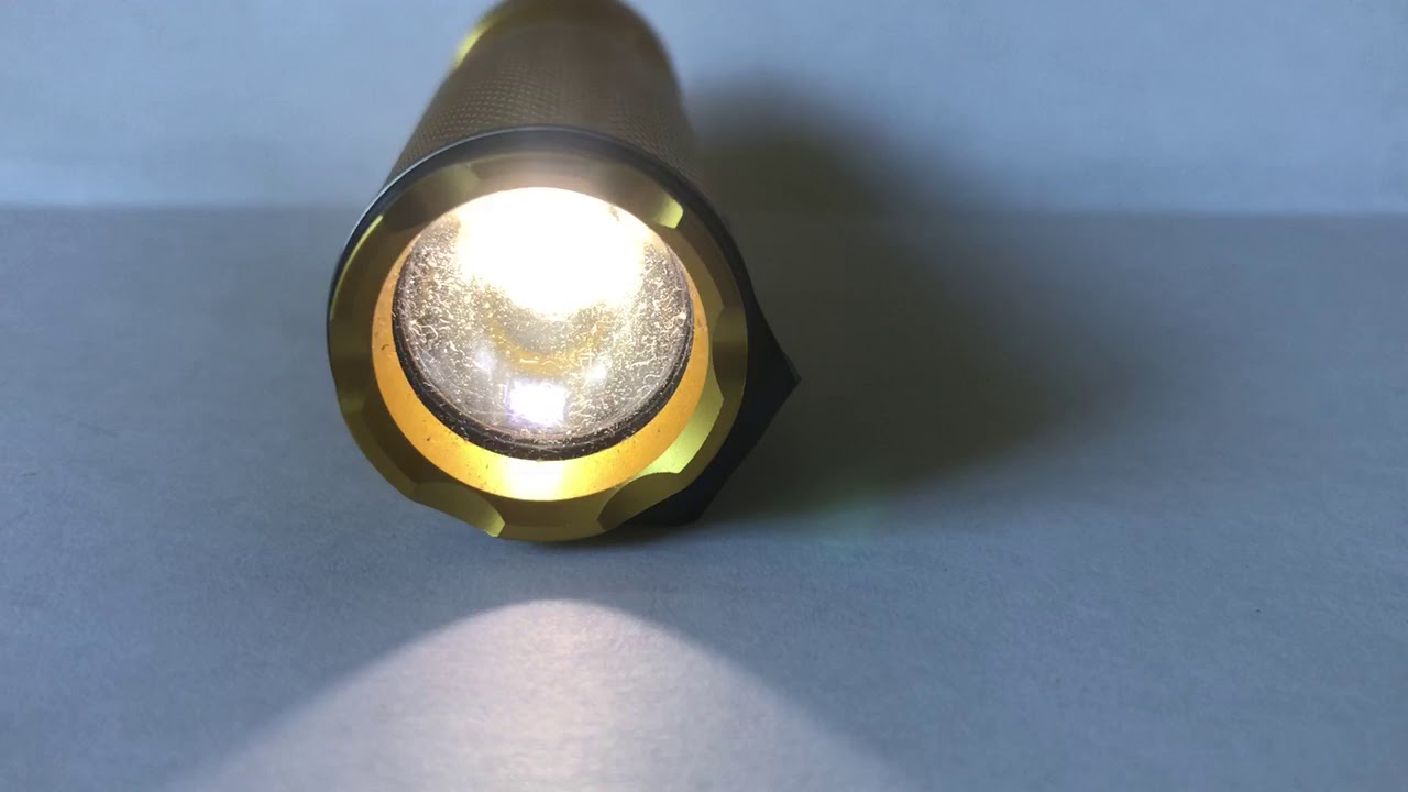

Received Gold Storm!
Super Happy ![]()
did not need factory reset, the light had been set up for double click to be 84 lumens and maximum is 95 lumens on my meter, so they looked the same. (my stock Novatac max is 74 lumens on my meter) The light was already previously unlocked, so it is programmable. I was able to lower the double click to 30 lumens… All is good.
fwiw, I really like the flat knurling on the Gold Storm, my delicate hands dont appreciate aggressive knurling. And, the Gold Storm has the reflector I prefer, with no rings. It even has the AR coating I prefer, with blue reflection, instead of green reflection… how picky am I? lol
