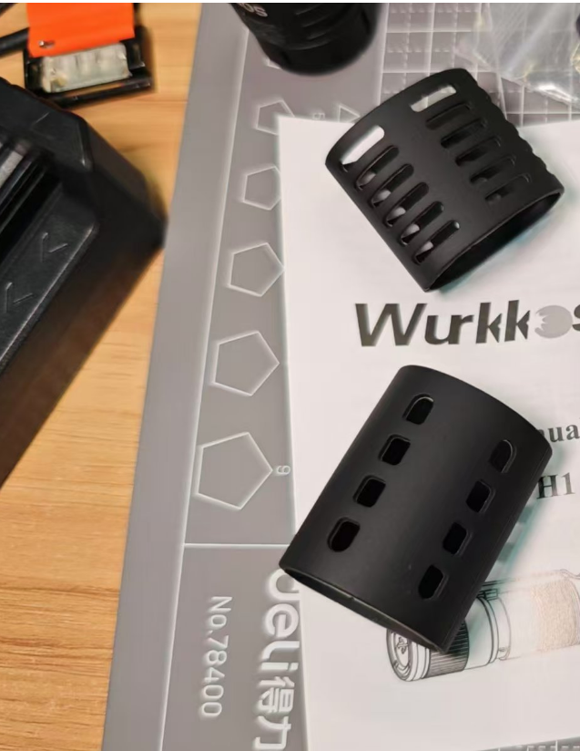

I assume these identical to those supplied with the H1A powerbank, they are sized for 21700 sized lights; if I were being picky, I’d say they are slightly oversized as the friction fit isn’t quite tight enough.

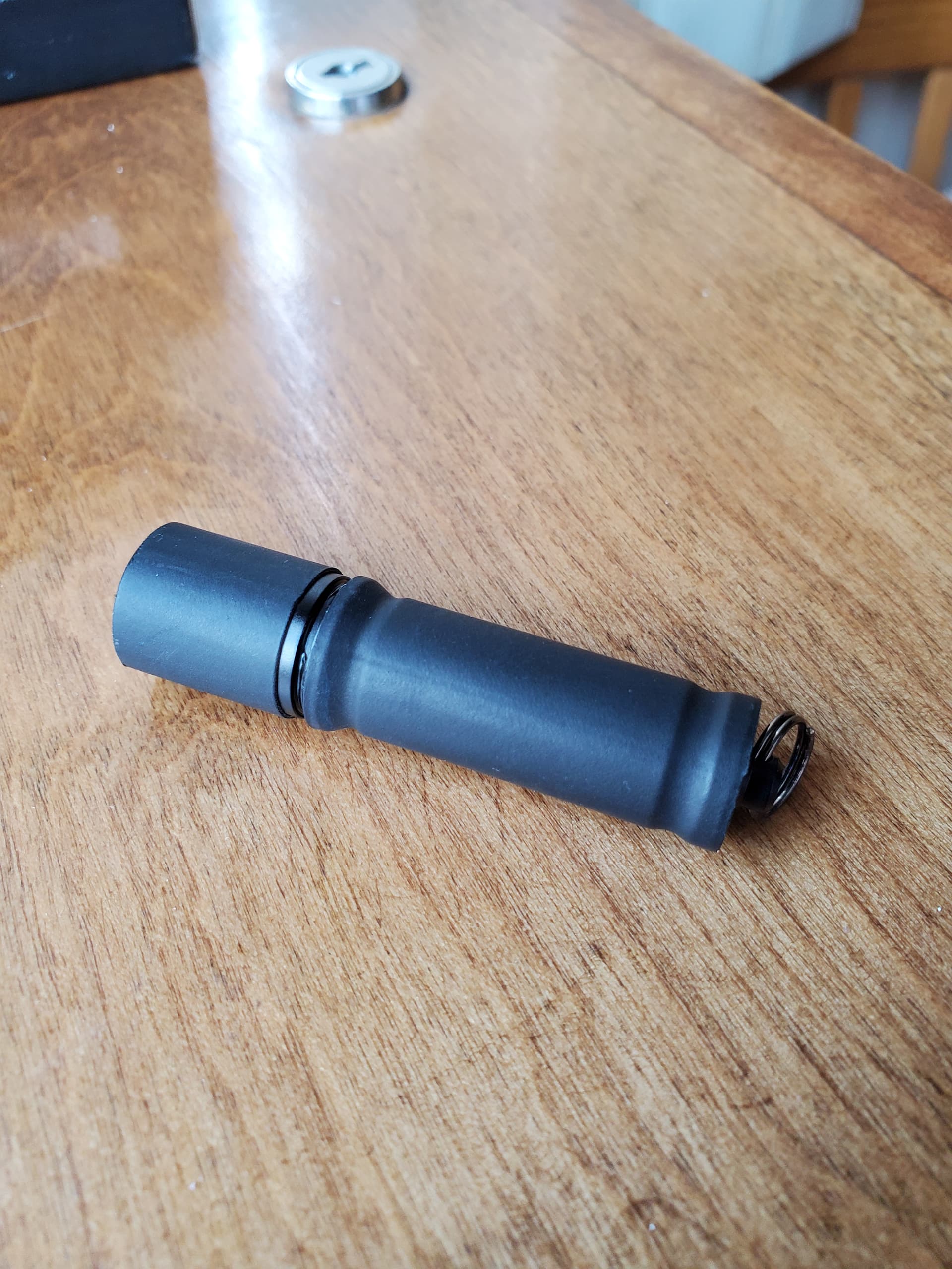

I’d like to report that I tried various tapes and the fishing rod shrink tube, and it looks like the gun grip stuff is the winner. Thank you @Firelight2!
Well it should be very grippy. Now to see if that stuff will stay on long term.
I think I would go with just the widest piece that you put on… Though your setup does look real nice!
I did at first, but the tube is small and although the grip was better, I felt more friction on wider parts would improve the grip. It did.
When properly heated I’ve never had Talon grip tape come off. It sticks great even in quite small pieces. It doesn’t come off even with heavy use.
After much use I have had the textured pattern on the surface of the tape wear slightly. However, it is easy enough to pull it off with a fingernail and some effort and reapply fresh grip tape.
