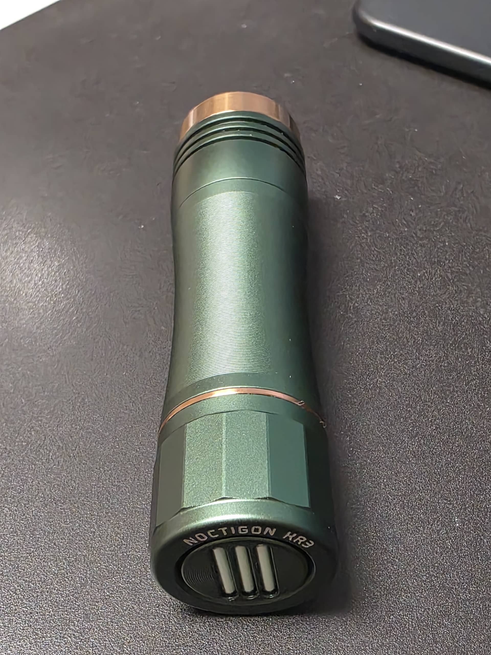

Tl;Dr: Pricing, size, NTG35 4200K LEDs, and overall performance are great. The aesthetics and pocket clip are phenomenal. The UI is a headache to set up but then it works very well. The switch and build quality are good. Just be aware you’ll need a separate battery and dedicated charger. I didn’t expect to find myself reaching for this KR3 instead of my usual Zebra SC65. It’s so cool and fun in a way my Zebra isn’t. Hank knocked it out of the park with this one.

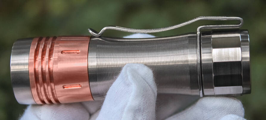

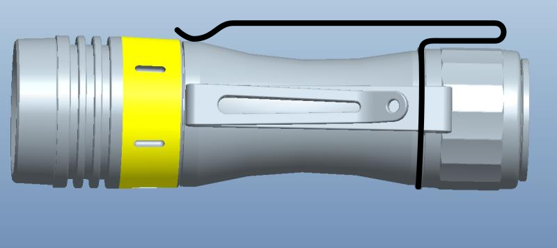

You should have seen the original KR4 clip. It was terrible. And so was the v2 he was thinking about making. So I designed a better one and sent the info to Hank, making sure to explain why I made it this way, like why the landing point should be on the body tube, not the head, and on a flat area with the correct angle, etc. He then improved it even more by adding a gentle curve which follows the body tube. And now it’s the standard clip on all his KR lights.
This is what I asked him to make… (the black line, not the 2-way clip)
… and then this is what he actually made:

So you’re to thank for the awesome clip! I’m so glad you talked him into it. It’s so nice. I can’t think of a single thing I’d change.

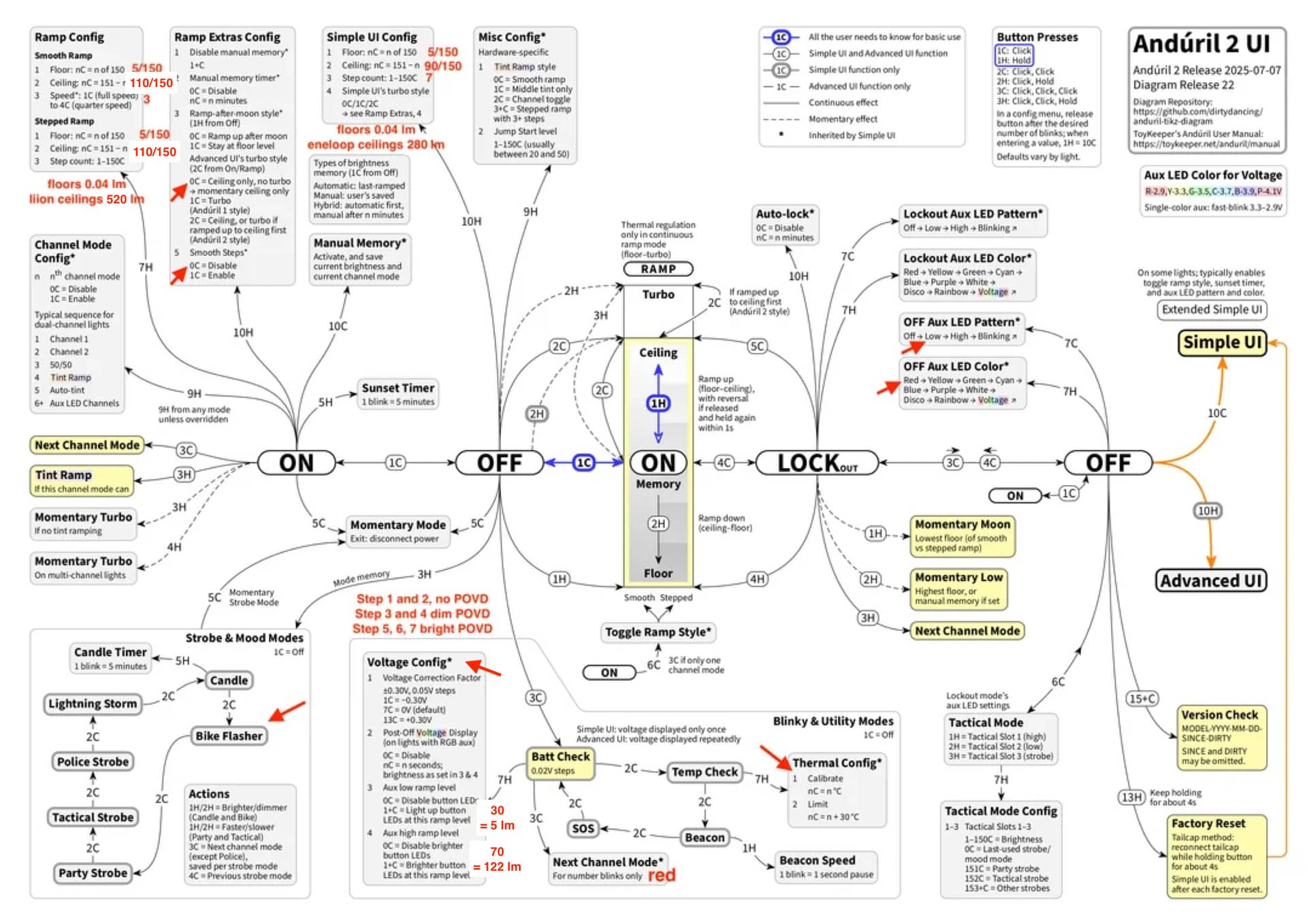

same.. and I lower ceilings below pocket burn level (which ime is at ~600 lm)
although instead of completely disabling POVD on my single channel Anduril lights, I have been using option 3 and 4 of the POVD menu to disable POVD only on steps 1 and 2…

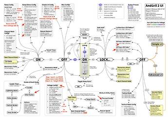

here is how I keep track of a my KR1AA options:
(I then save the options in a pymcuprog hex file so I can reflash to them, for a given model)
same, I calibrate batt check voltage to a DMM..
I also check resting temperature with an IR thermometer, and recalibrate accordingly…
I find default temperature is often off substantially (sometimes as much as 15F too low)
