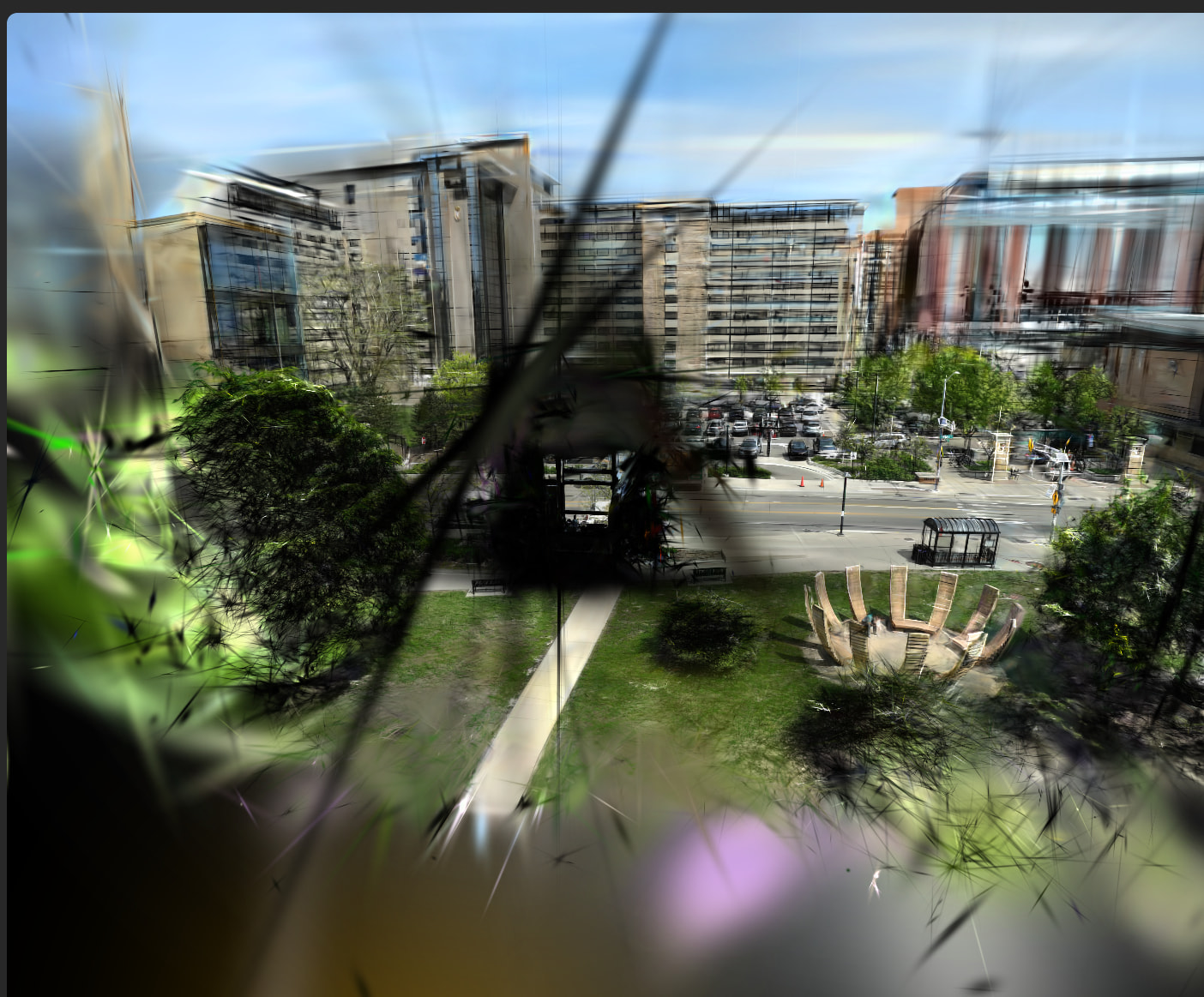

check out this splat, incredible detail when viewed from my dorm “window” and any other perspective is unintelligible
view it from this floating black window of sorts
This is extremely neat! Took a while to figure out where the window is in the black void behind the camera. It was super fun crossing the street to see how things look from the other side!
I was wondering if shadowing, lens flare, vignetting, prismatic scattering/reflections, DOF, and auto white balancing might cause those weird little artefacts. . .
white balance was locked, otherwise i would agree yes.
BUT!!
i found a huge source of floaters. about 30 images including a poster have been tracked to the wrong place. i have two of the identical poster in my room and it seems to have confused the program. im currently going through by hand and finding these and removing them before i re-run all the data

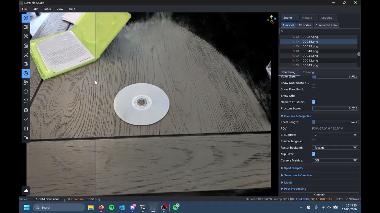

i havent yet found a spare reflector, i did find a cd though.
sadly im limited to using my phone camera while away from university, this introduces variable img settings, low resolution, mandatory image stabilisation, and a myriad of other issues with the processing applied. the splat is worse. but here it is
i will try again when i have access to a real camera

Thanks for doing this! The image quality is certainly not as good as the room splat for the reasons you stated, but it does demonstrate how the program handled the reflection+iridescence.

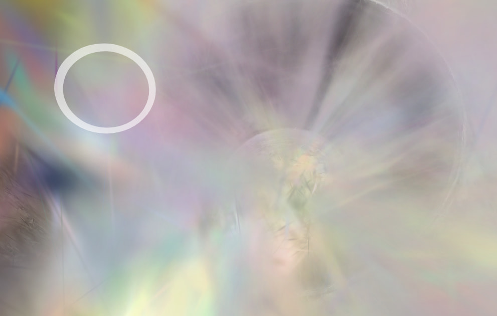

Similarly to the mirror, it created extra physical space under the CD (into the table) to realize the reflections. Here’s the view from under the CD:
Reminds me of the shimmer in the film Annihilation (2018).
im hoping thats only due to a lack of a second perspective, if the disc were upright it might not do that - of course i shouldve throught about that before the scan

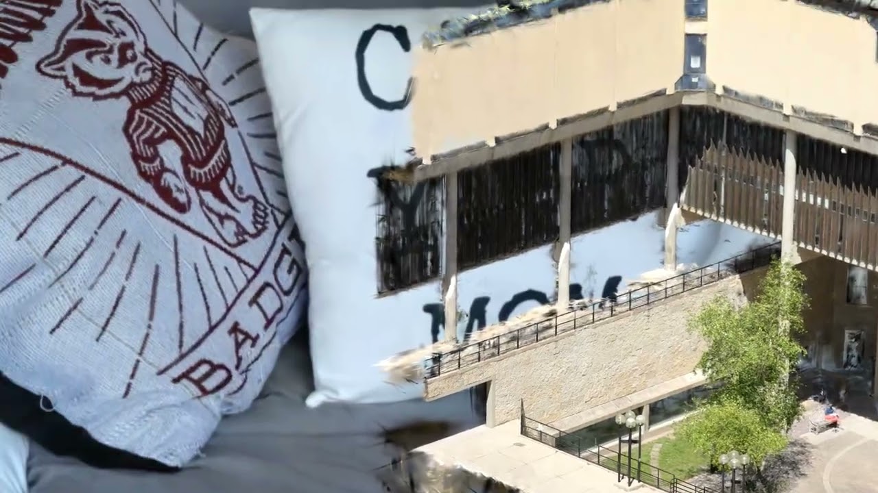

ive been playing around with an old scan
Breedlove.. :+1:t4:
call your mom…:+1:t4:
