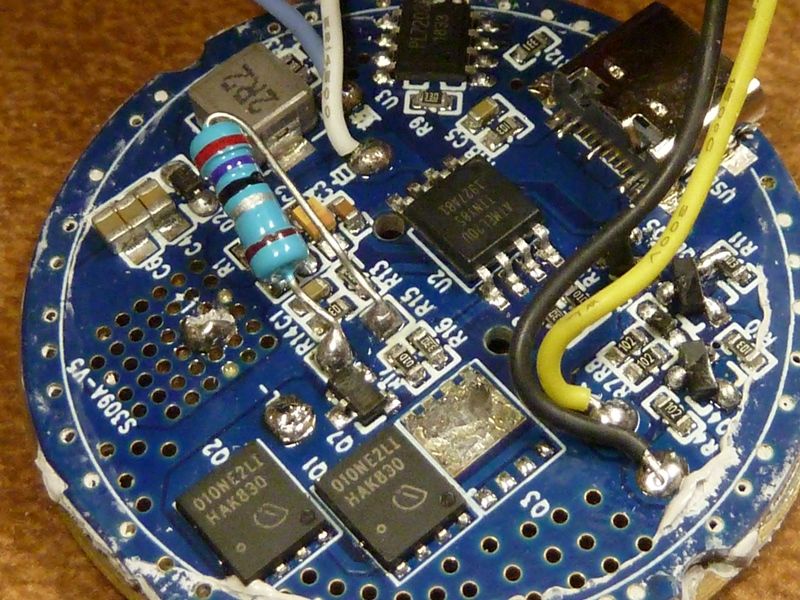

I don't have a Q8 Pro to test and compare with, but I can tell you the HK04 has some advantages in that they are using quality springs, better than the Q8's (if the Q8 Pro is the same as standard Q8's), and the driver is more advanced with dual FET's that in theory should help for the 4 high powered LED's:
It's all a matter of the tradeoff's of a more compact (thinner) design vs. 1 more cell.
