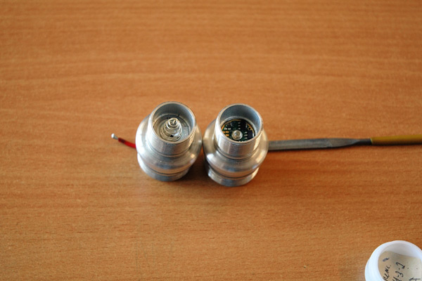

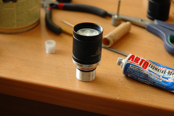

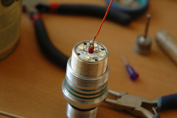

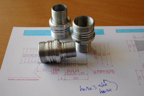

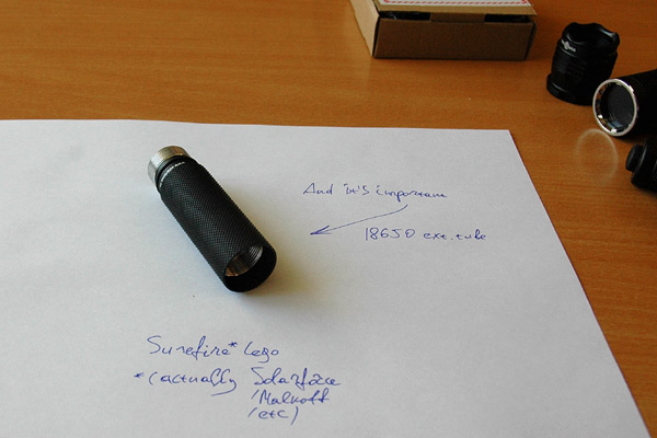

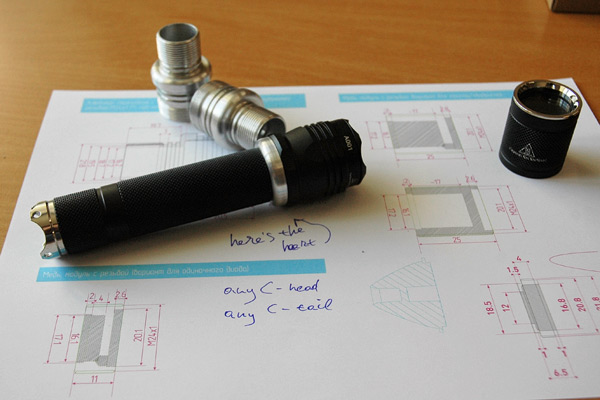

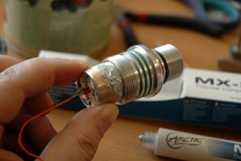

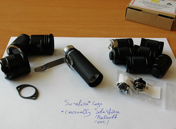

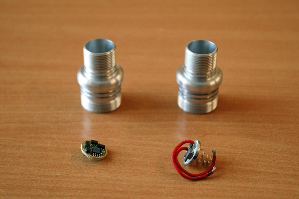

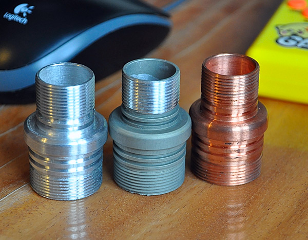

Hi everyone, I’m Dsche, the author of ‘OrthoDogs’ solution for converting cheap|widespread Solarforce|Surefire lego to modern powerful torch
Due wide range of inner diameter of ‘standard’ D26|P60 body any drop-in is wasting of time and money (well, you may fill it with some foil… or something else… but it was no solution at all, just crutch)
Here the one possible solution I’ve found
Anyone may purchase one from me or produce it by itself in trade for little donate (say $2 per light)
Thank you and good light!

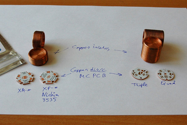

Have you made more of your copper triples and quads?
