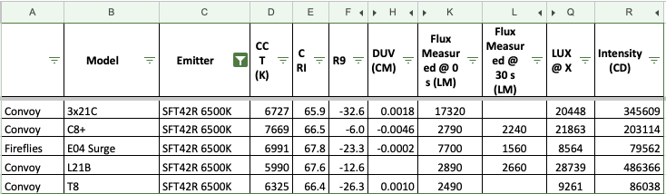

I have used the SFT42r in a few. It’s a beast. Yes, my L21b with 20A is over-driving the sft42 emitter and no, it hasn’t burned up now.
20A? Impressive numbers. I see you have the 6500K, I might get a couple of them together with the 5700K ones. How do you like the tint?
It is possible that the emitter is driven well under 20A, due to Vf rise of the LED and voltage sag of the battery under load. 20A driver means that it can output up to 20A under ideal conditions, not in every instance.
Yeah, I don’t disagree. I only bring it up because every time I post these numbers, I get replies that seems like people are borderline offend that I’m intentionally over-driving it. In reality I thought Convoy 20A driver (similar to the 6V8A) doesn’t actually supply 20A.

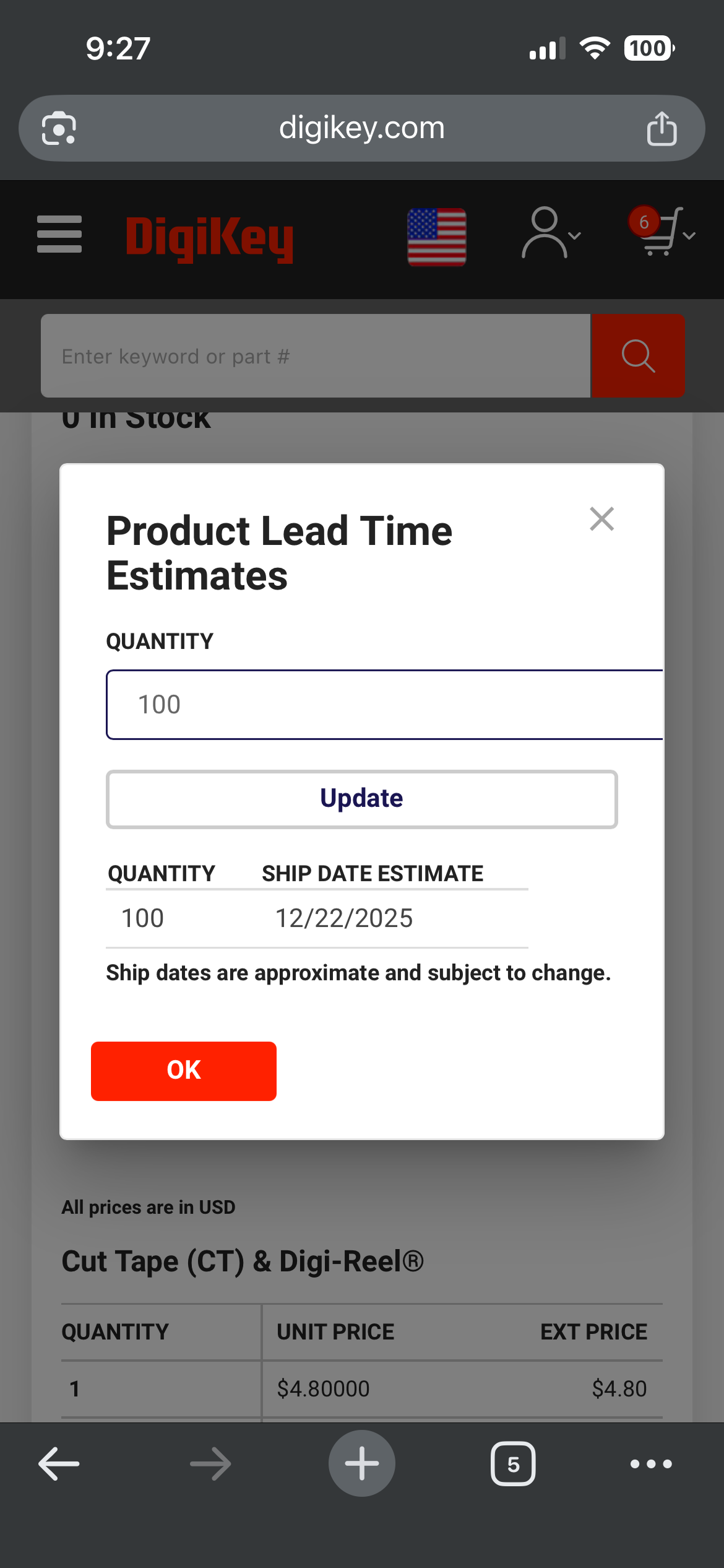

Is there any reseller who sells the XM-MR in small amounts? Would be very interested to try this one out!
DigiKey is expected to have them in about a month:
https://www.digikey.com/en/products/filter/led-white-lighting/124
I’m measuring over 2900 lumens at 30s driven at just 10A. That 20A driver is resulting in lower output, but you do you.
It does, I measured it alongside the 22mm FET that hits 24A and reads just slightly higher in output.
Yes, if the emitter Vf is lower than the battery voltage sag and other resisyance voltage sag. Someone measured 14A with a FET driver, so the 20A buck schould be similar in practice.
Do you have the 17mm 10A drivers in the C8+ and the T8?
No, the C8+ has the H17Fx, the T8 has the 10A I believe. I ran out of H17FX when T8 came in.
