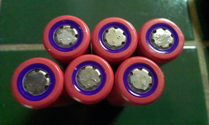

I dropped by my local Home Depot yesterday, stuck my hand inside the grab-bag o’ batteries (recycling bin) and pulled out a Dell laptop battery. After tearing it apart I found these
Sanyos…maybe 2000mAh? I searched and couldn’t find a thread that told what capacity they were, by color.
EDIT: Figured THAT one out! ^

Nice score. Are there faint water marks on the wrapper. Should see a line that says Sanyo with a model number. Next line should have a date code.
Like ImA4Wheelr said, those look to be Sanyos. The ones I’ve pulled have all had a faint raised imprint in the wrapper.
Yes, the imprint says “SANYO R1112” then under that it says “035B”
OK, think I’ve got it. R1112 means UR18650A - nominal capacity 2150mAh
O35B means 35th week of 2010.

How did you find the codes for the date? Are the codes for dates interchangeable with other brands?
For cell capacity I've been having good luck with this formula, if you ever wanted to guess cell mAh from what the laptop pack says:
[(Total Pack Capacity (mAh) * # of cells in pack) / # of parallels] / total # of cells = mAh per 18650 cell.
