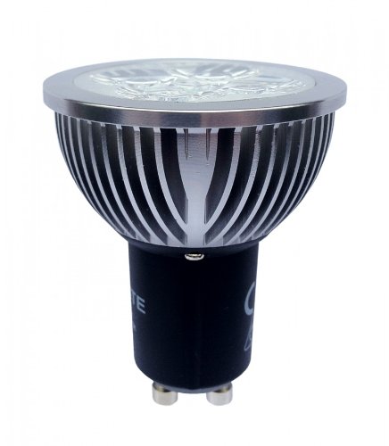

I need help with getting a driver, but first need to know what led’s they are and voltage etc (I think they may be epistar 1w 300mA 3.2-3.4v).
They came out of a GU10 led 6.6w lamp - this one Pro-Lite Dimmable LED GU10 Sun-Star Pro 6.6w spot bulb (daylight, 6w, 6000K)
The plate has no resistors or anything, just the leds and 2 wires (which went to a 240v driver) it says it’s 6.6w so they must have been over driven as it says 4x1w in the text on the board.
Do you think this could be made to run of 1 or 2 18650’s? which driver if you do - I will be beefing up the back with some solid copper so may be driven a little harder than 1.65w each.

those are generic 1 or 3 watt luxeon clones.they appear to be wired in series and with a vf averaging 3.5v you need around 14v + or -.
limit current to 350ma.
the 3w version i have take dd from an 18650 with with nothing but a quarter and a thin tube for a heatsink.
with the bulbs rating of 6.6w those are bound to be 1w parts.
the standard build methods dictate that not a fraction of a cent more than absolutely needed will be spent on the parts.and the whole thing is built right to the edge.
