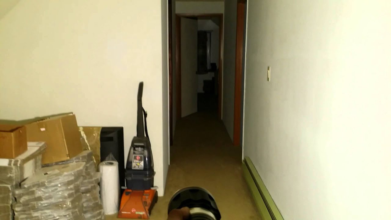

#2
TN36Mvn flood like nothing else! Beam shots does not do this light justice
http://www.candlepowerforums.com/vb/showthread.php?393737-TN36vn-Brightest-Pop-Can-Light
