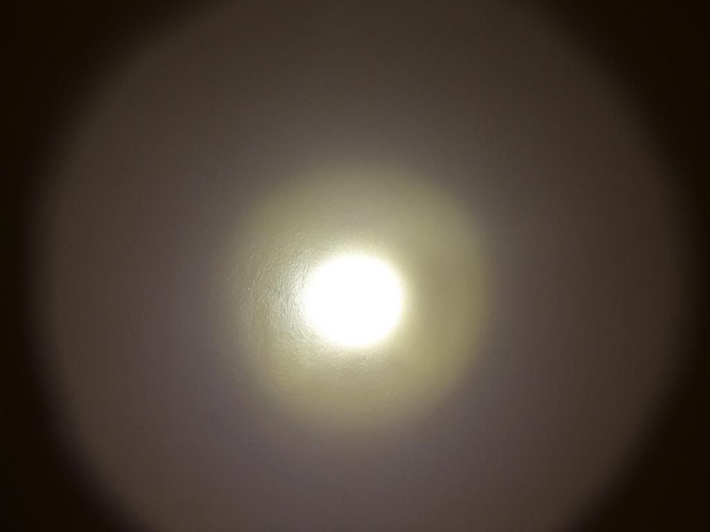

Here’s the beam shot of my messed up X-10 reflector.
I’m posting it so that other BLF members won’t commit the same mistake.

Aside from that, I have actually done the same as you have a few times on P60 reflectors and never found it to noticably affect the beam. Are you sure it is all sitting back together as it should? As it could be some other change that’s actually causing the beam profile changes.
Oh! That’s new to me. I think I have to try it on a ‘lesser’ reflector first before trying it on the X-10. Thanx Chloe!
