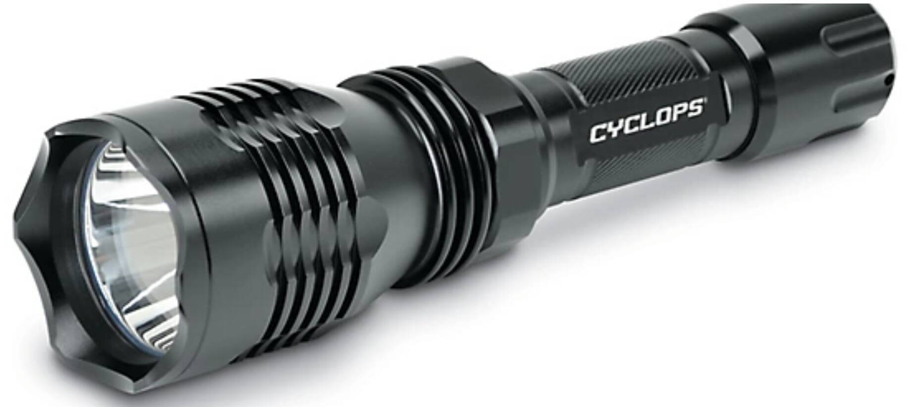

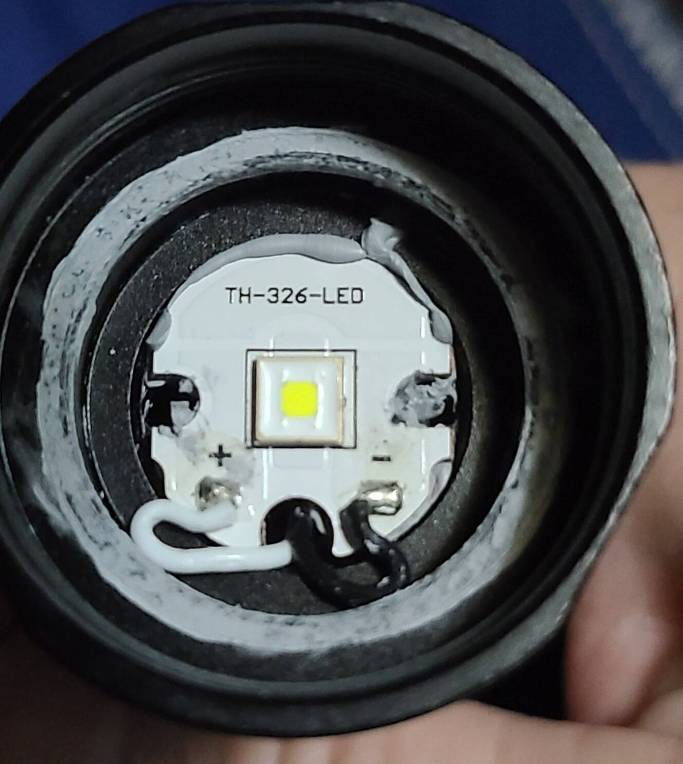

I have one of these… shoots a tight beam, i upped the power with a SFT-25R and a 8 amp driver..
Still just does get warm, so i know it can handle more.. but it takes a small 16-17mm pcb and driver..
I dont have a clue as to what other L.E.D.s would handle 13-15 amps and keep the beam i have now like the 25R does…
Would it mess me up going from 3535 to 5050 ?
Also.. are BoroFloat lenses worth it vs AR Tempered glass lenses ?
