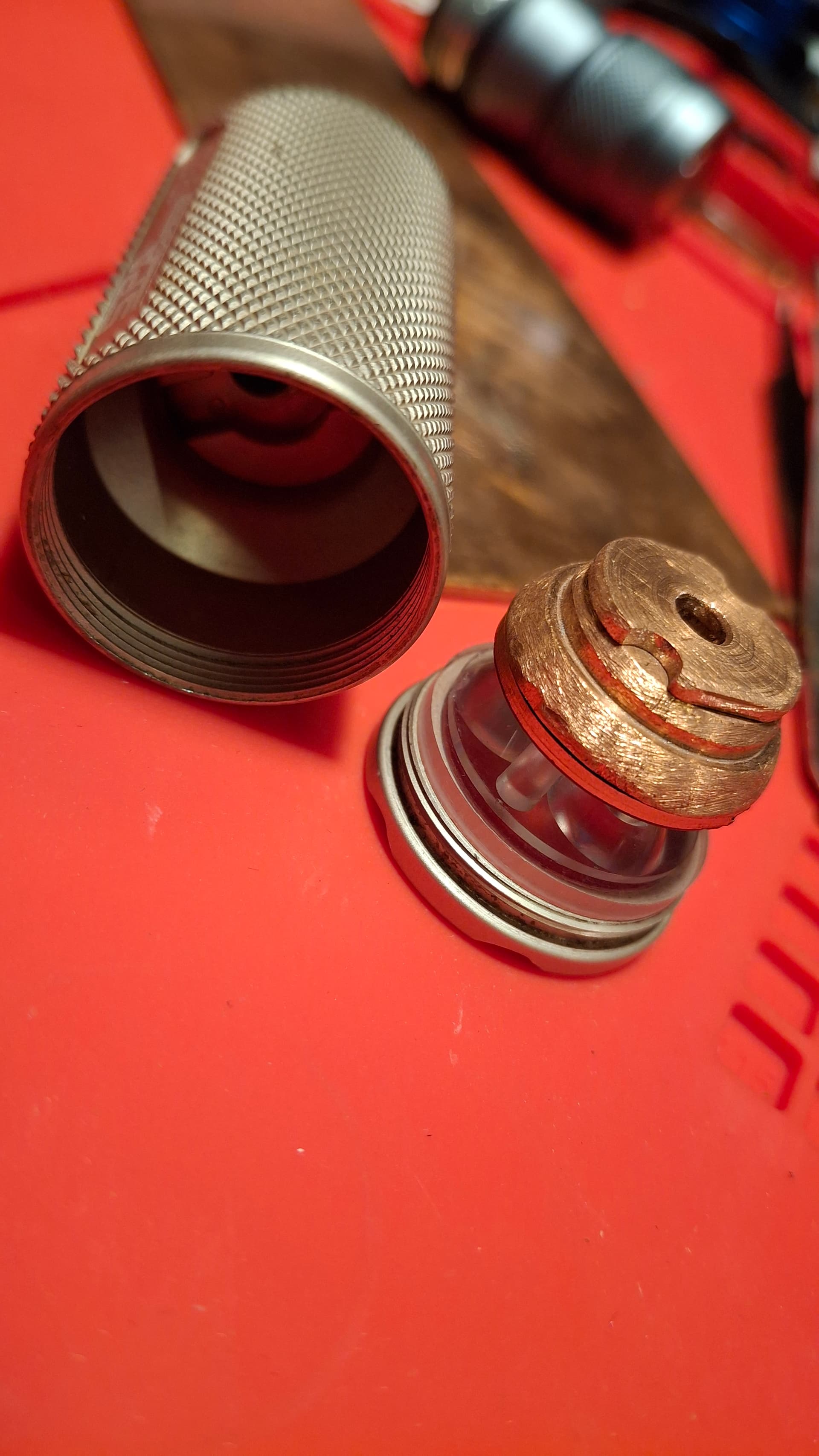

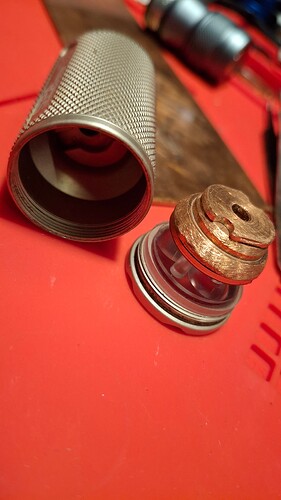

I have heavily filed a copper Convoy S2+ triple spacer, which will sit atop a sanded 16mm mcpcb on top of the pill inside the head where it narrows down to hold the original reflector.
I decided to use the S2+ spacer instead of the aluminum atomizer stand because I didn’t really have any way to secure it enough for power tools. Eventually I will purchase a jeweler’s vise as recommend by u/-Cheule- (I cannot seem to find his account).
Having test fit everything, it appears that all will fit well with enough room for attaching an FW3A clip behind the bezel, using the stock 2mm thick plastic lens, which has green AR coating. It seems that I can remove the clip and go back to the sanded to 22.5mm FW3A glass lens.

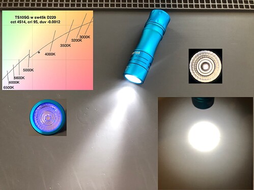

Here is a recent mod using an sw45k from Simon:
notice the Duv is just -0.0012

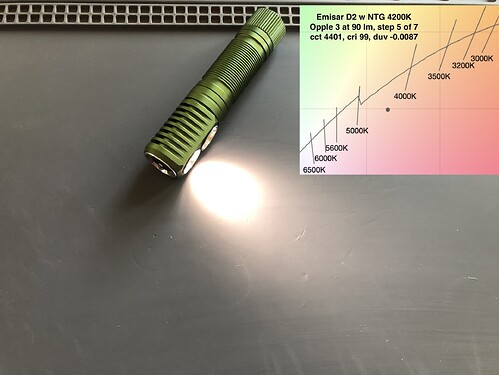

I recently tried a new LED from Hank, NTG35 4200K. It has become a new personal favorite, this one measures Duv -0.0087.. it is very nice imo.. still not excessively rosy.
And the NTG35 4200K produces about 70% 35% more lumens than sw45k..
The NTG35 4200K is imho the new alternative to sw45k D220. The NTG is slightly more rosy, and has higher output than sw45k.

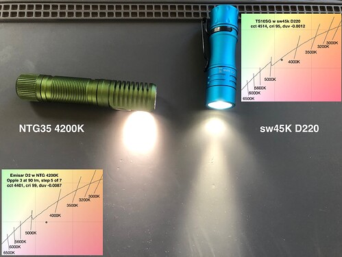

here is the sw45k next to the NTG35.. we can see the sw45k looks relatively more greenish (less rosy):

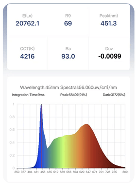

btw, the NTG is not shown as 9080, a recent test from a friend w a Hopolocor measured the R9 at 69:
