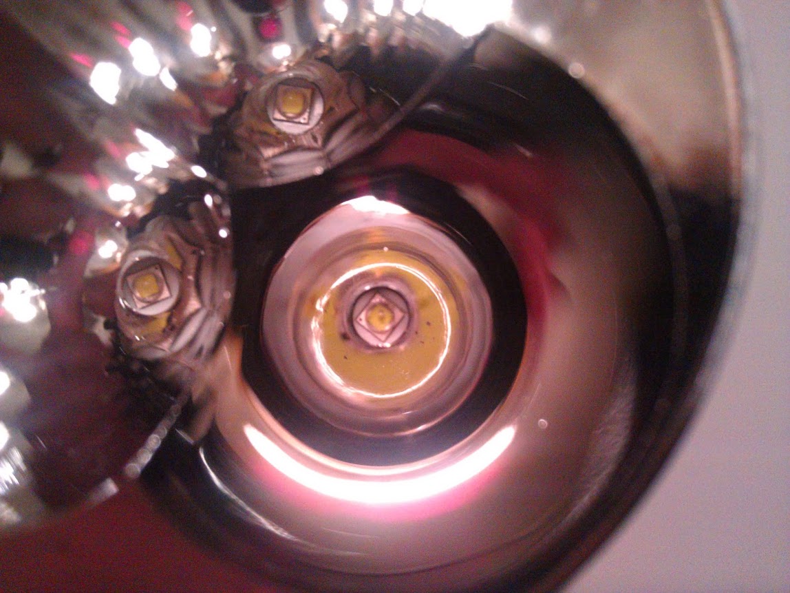

Even more interesting was a 3D triple emitter with a deep reflector. It's quite throwy, but has a good balance of flood too. XPG2 or XPE2, can anyone tell from the pictures? Very nice body with thick fins, body tube and tail cap. I really like the look of it. The pictures below don't do it justice. Anno is cheap though. Easily scratches Plastic lens and reflector. The reflector is a little cheap looking, but works well. Couldn't get the driver retaining ring loose. Rough measurements:

Definitely looks like XP-G2’s in the tripple-emitter light.
Wondering about the reflector? Aluminum I hope…
The shiny inside surface and appearance makes it look like a chromed plastic reflector.

With the emitters on silver boards, it DEFINITELY looks like XP-G2s in these lights.
