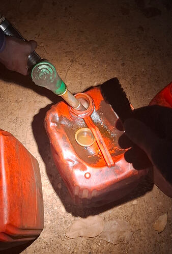

I was reminded of this thread last night…
For various reasons, I had to provide lighting for filling some plastic containers with diesel…
Wurkkos HD10 was the light I had on me at the time, no firey death was encountered, thankfully.
Isn’t diesel one of the safer fuels when it comes to combustability? It needs to be vaporized or heated up significantly to ignite, no?
Yeah you could light this with a torch and you would be fine
Correct, from my understanding, still… ambient temps of c.22C, I could see shadow of the vapours from the light.
Let’s clarify this. But don’t try any of this at home. If you’ve ever looked into a diesel fuel tank or can that just very recently had fuel added to it you will see a mist in the tank. What you were seeing was a diesel mist not vapors. As the fuel is shooting out of the nozzle and splashing off the bottom or off other fuel that’s already in the tank it’s creating an aerated mist of very very tiny diesel droplets. And the mist is coming out because fuel is going in and filling that airspace. So you could have lit that scene with an open flame but you would NOT want to get that open flame into the mist. The mist will stop coming out as soon as you stop filling the tank. But the mist will stay in the tank for some time.
Diesel fuel isn’t really going to create vapors until you get the fuel temperature up to 52 C. So an open container of “cooler” diesel fuel that hasn’t recently been stirred up or aerated could have an open flame passed over the open cap without a problem as long as the fuel temperature is below 52 C. And if the mist is not actively being pushed up and out you could still pass an open flame over the top without a problem as long as you don’t put the flame down into the open cap. And there is no good reason to put a flashlight on high or turbo down into the mist in a recently filled diesel tank.
