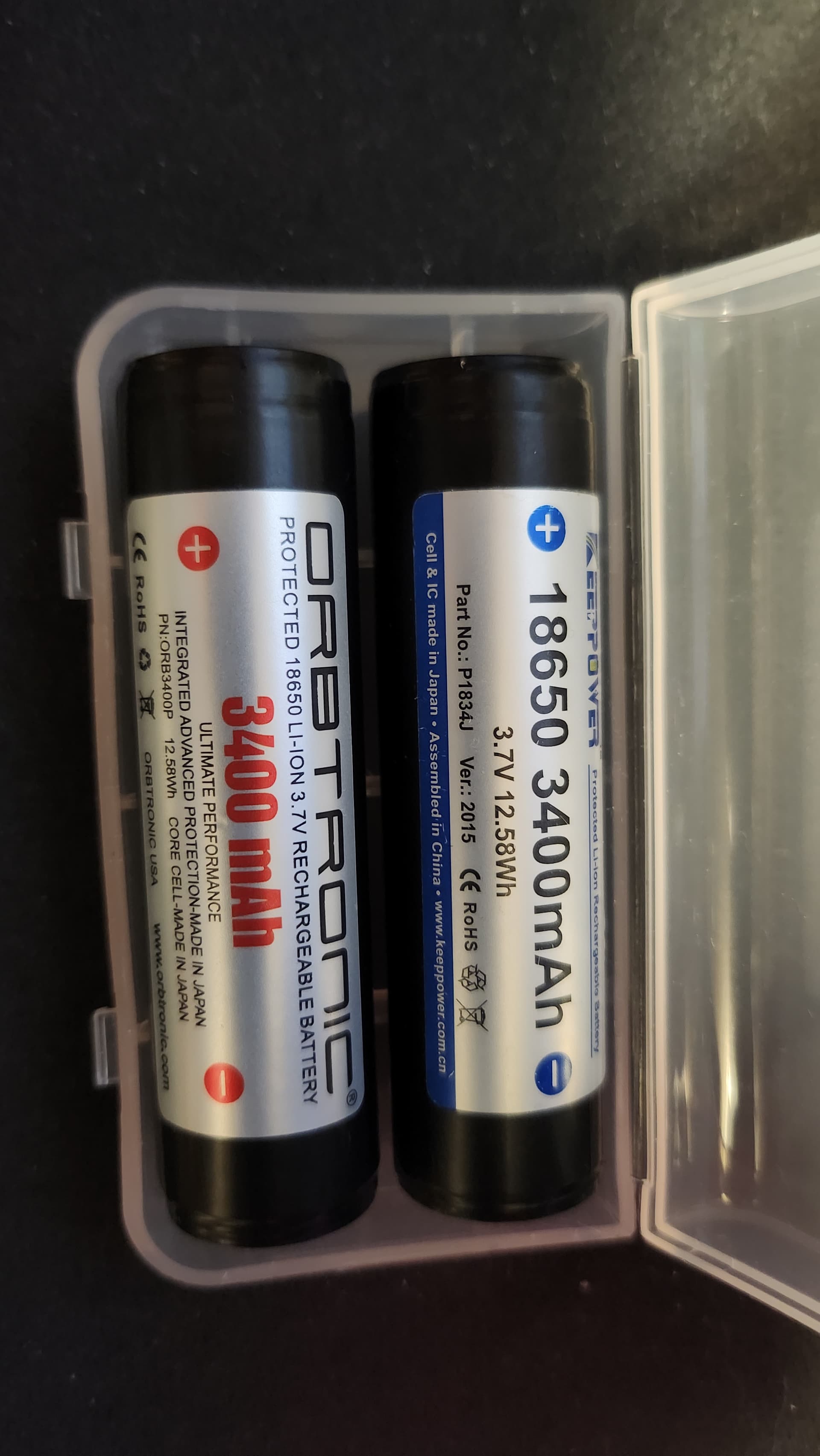

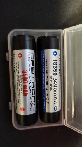

For a 3400mAh lithium Ion cell, with a NOMINAL voltage of 3.7V
P(Wh)=I(Ah) × V, so
P = 3.4×3.7=12.58 Wh.

In the context of promoting a 4000mAh 18650 cell that’s bundled in with a flashlight that has a power bank feature, it can be a bit misleading if the cell has had a protection circuit added or the flashlight has a cut-off of around 3.2V. The power bank may not get anywhere near the 4000 mAh stated.

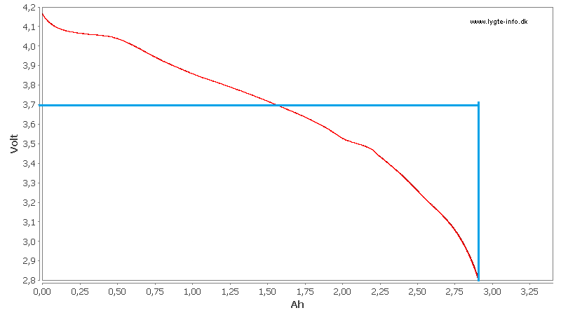

Excellent observation! Since the voltage is variable across the discharge, naively multiplying capacity with voltage does not yield an accurate measurement.
However, if you view this product as the area of a rectangle with mAh and V as side lengths, it naturally generalizes to the area under the voltage-vs-mAh discharge curve, i.e., the integral of voltage against mAh-capacity.
In the graph above, the red area is the true total energy in mWh, while the blue area is the naive product of nominal voltage and mAh-capacity. In most cases, the latter is a decent enough approximation of the former.
Of course, the true total energy in practice also varies inversely with discharge current: the greater the current, the greater the voltage sag and the earlier the cutoff.
