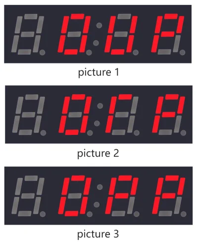

4.It has protection function, so normally it won’t be broken unless you reverse the input or use very high voltage:
    • OVP( over-voltage protection):when the real voltage is between 25V and 30V, the output will be cut off and there will be a “OVP” on the screen, and the device will be damaged permanently when the voltage is over 30V.
    • OTP( over-temperature protection): when the temperature of the load is over80℃, the output will be cut off and there will be a “OTP” on the screen.
    • OPP(over-power protection): when the real power of the load is over 35W( 25W for HD25 ), the output will be cut off and there will be a “OPP” on the screen.
