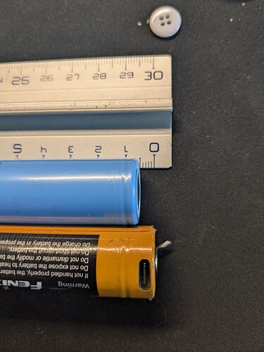

it’s 5mm shorter:

By the way: on your photo you compare a regular unprotected flattop, with a 21700 with build in charging (and protection), which are always ‘longer than normal’. Does the flashlight has springs on both sides? And have you already tried if the unprotected battery makes good contact? The springs can normally compensate quite a bit for the length of the cell.
Most likely the unprotected cell is still around 70mm (± 1mm) long and that protect fenix cell, could easily be 74mm. (And for some flashlights that could even be too long.)

I’d guess your new cell is a regular 21700 and the Fenix cell is longer than 21700 specs due to the built in charging.

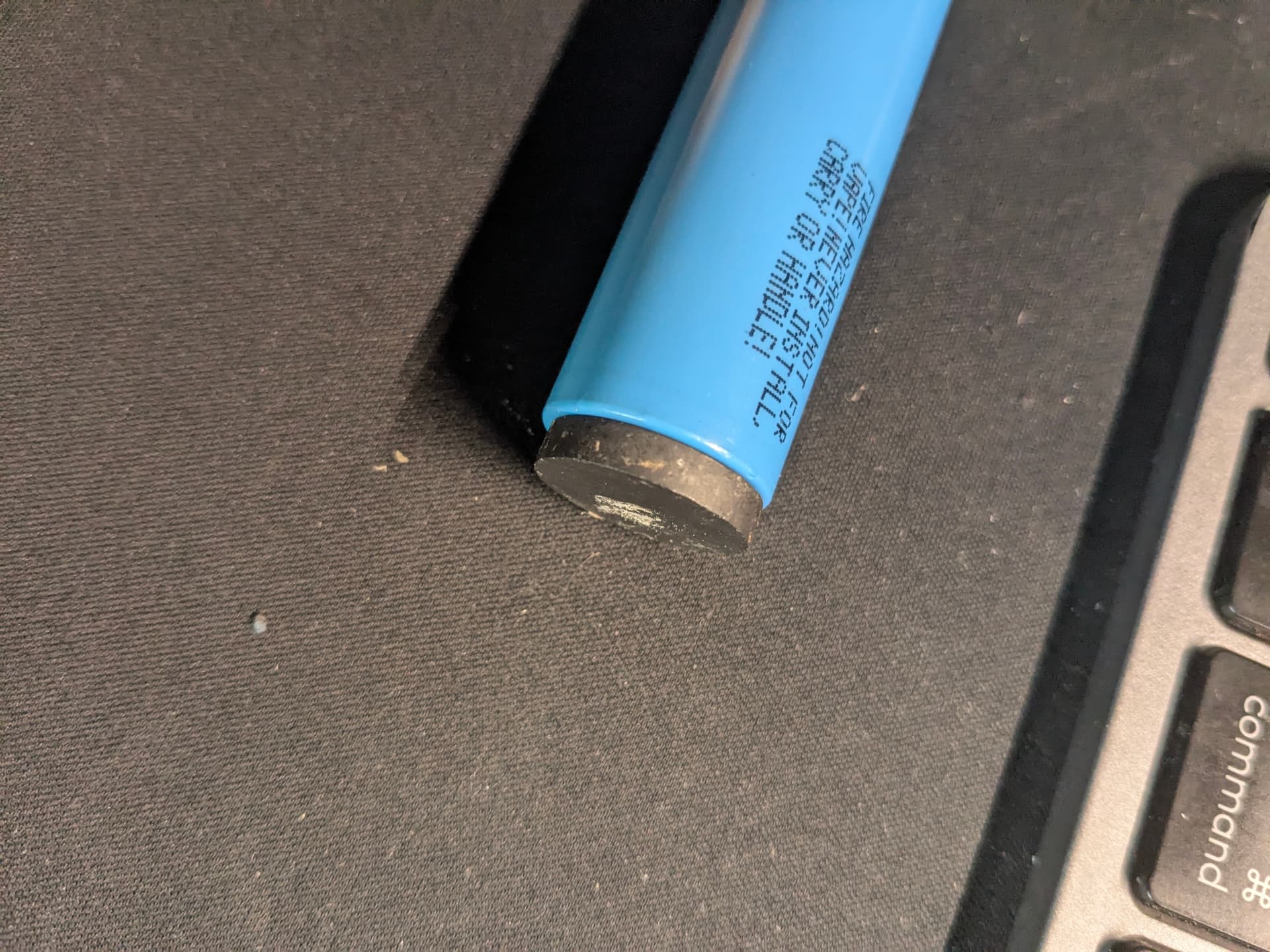

Because i tried. You mean normal, flat magnet? If so, I tried with two magnet which i took from fridge, but none of them worked
Often people will put a small magnet on the positive contact to turn a cell into a “button top”. This is dangerous as outer case of the cell is the the negative contact, and connected to the body of the light, if the magnet shifts and bridges the positive pole of the cell with the body, this is a short circuit.
The spacers method, especially when heatshrinked, looks like it will be much safer.
Is the magnet sitting on top of the shrink wrap? If so it’s not going to make contact with the battery.

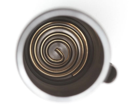

Have you considered just stretching the spring to make it 5mm longer? I don’t own an E35, but from what I see on the internet it appears to be a spring that could easily be elongated: 1lumen Fenix E35 v3 Review

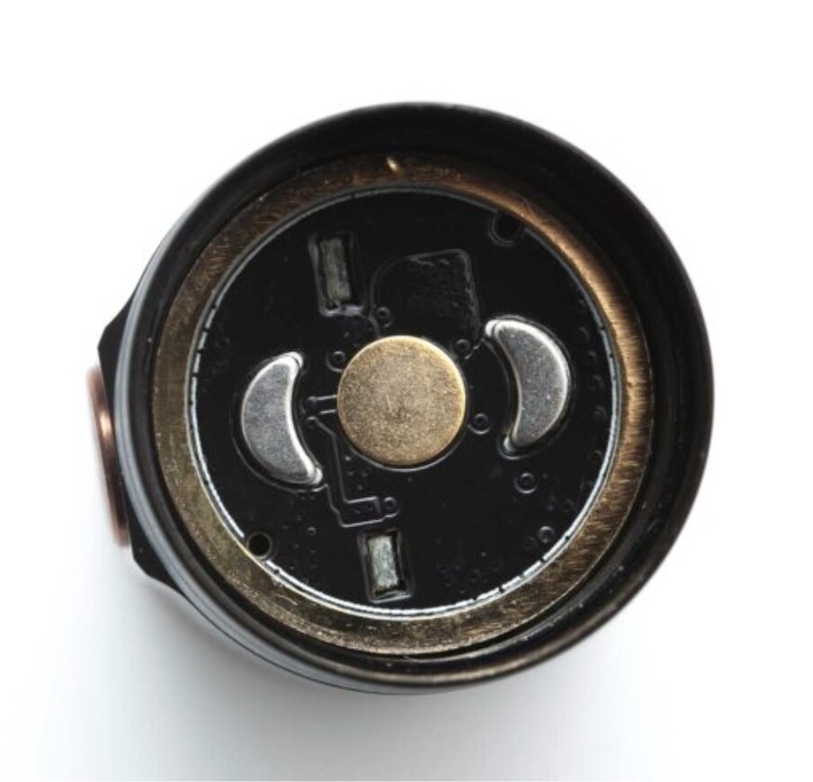

Your flashlight has a reverse polarity protection and that requires button tops to be used.
Photo by 1Lumen
