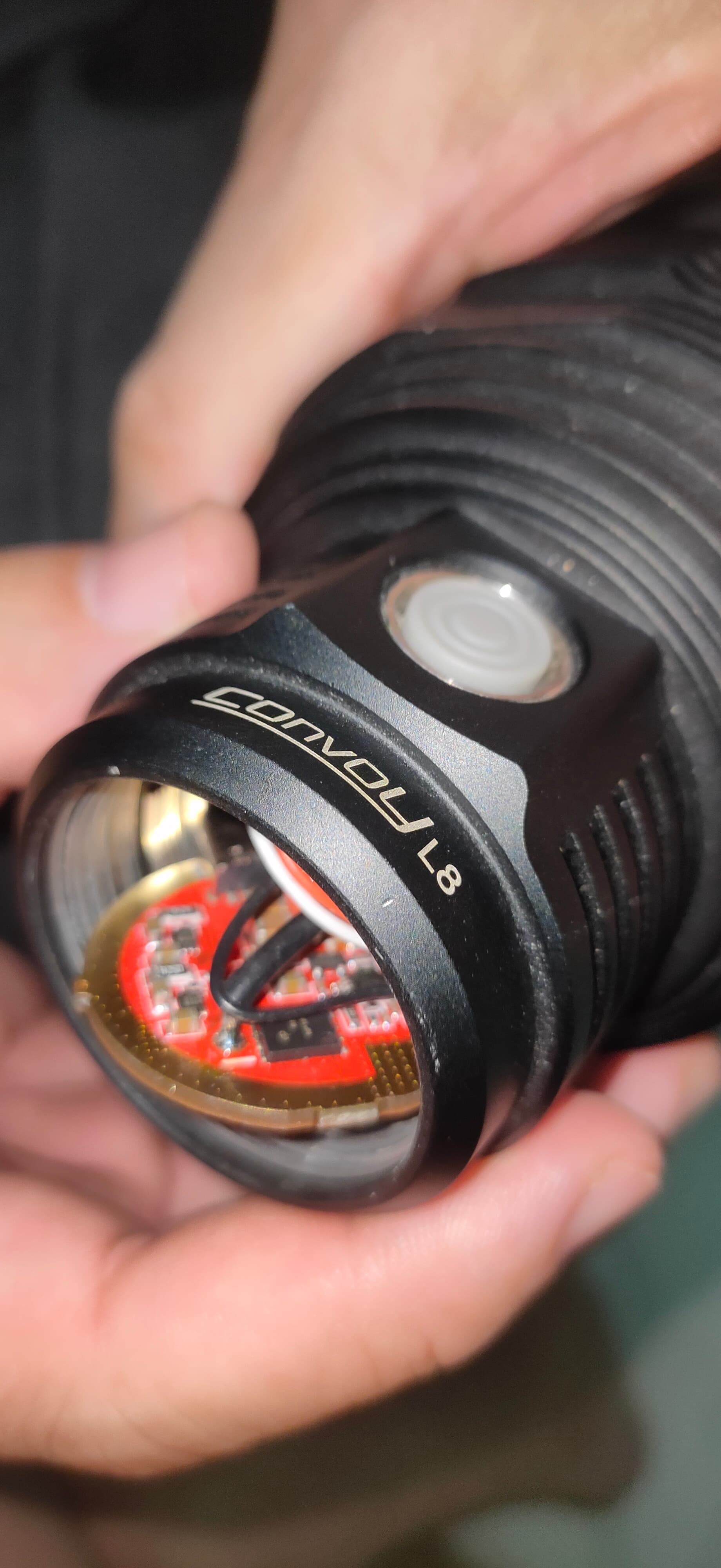

Hi, Newbie here, need help, im having problem with my L8, trying to visualize how to remove the PCB switch, do u remove it from the inside or from the outside? do u just yank it out? much appreciated! TIA (bought a new L8 driver)

If I’m not mistaken, you can remove the ring around the rubber button, outside.
The metal ring should have 4 small grooves that you can use to remove it, by using pliers; then you remove the button and you should have access to the switch.
Careful so that you don’t tear any wires, from the switch to driver or from the driver to LED.
