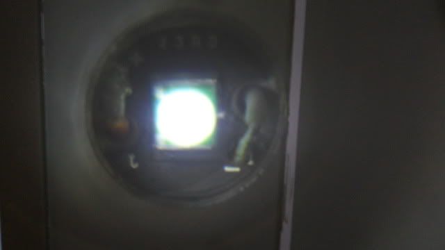

I just put together a XML2 at 5.5A with the DX 78mm aspheric. however nicely focused it projects the image of the emitter on to the wall. The picture is of one of my other attempts at something but you get the idea. I was thinking of spraying the inside around the emitter with plasiti dip or something. Will that stop it? and if so should I use a light color or dark color.
Lol never had this…I always get the visible stripes…and this can be easyly fixed with slightly defocusing

Try cutting a disc from electrical insulating tape, just for testing to see if it works
Use flat black inside. That's what is usually used. Flat black spray paint or black cardboard.

Nope 5.5A on a sinkpad. The picture is of one of my different lights that has a more pronounced effect.

Flat black is best for no artifacts. I would try a lighter color as well as it at least reflects some light around inside.
Flat black absorbs light much more readily so lumens may drop a bit but cant say definitively. Artifacts will decrease though :~
