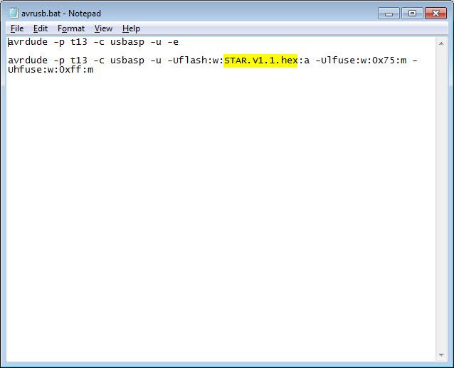

right click on .bat file, select edit, and make sure the EXACT name of the.hex file is in the *.bat file
Open a command prompt (start orb, type cmd, then change directory to the directory with the .bat file and.hex file)
cd c:\avrusb
Run the *.bat file, if you have all the pins wired correctly, the driver and AVRDude loaded and the SOIC clip on the chip, you should see the commands flash by pretty quick and erase and reprogram your ATtiny13A with new custom firmware

C:\avrusb>avrdude -p t13 -c usbasp -u -Uflash:w:STAR.V1.1.hex:a -Ulfuse:w:0×75:m -Uhfuse:w:0xff:m

*.bat file courtesy of comfychair
Thanks, now if I can just get the USB programmer installed I might, might, just get somewhere.
I use this bat file.
If you want to flash NLITE.hex, for example, just type:
flash NLITE
Nice…flag to install whatever *.hex file is in the directory automatically…sweet! Thanks
% = “all” in a batch file…so %1 means all1.hex, excellent

I'm confused a bit by what you mean by "% = "all" in a batch file". %1 is basically "variable 1", so it would be the bat file then whatever comes after becomes %1, or "variable 1". I think that you can have up to 4 of these, after that you've got to change how you write the batch file.
Example:
FLASH STAR1.1 LOCK
BATCH %1 %2 (if it were actually used).
Yup, you are right
So with the *.hex being the next file in the directory, it becomes argument variable %1 automatically…good call
I had 3 different .hex files in the directory, so I manually go in and edit the.bat just to make 100% sure I ain’t doing something wrong…lord knows with my luck I would run the *.bat and erase 90% of my drive or something
No, it doesn't automatically choose any hex file, that's the point of it; you choose which hex file you want to flash by which name you put after typing flash. I have about 50 in my folder, this makes it easier for me. You don't ever need to edit the hex file unless you are flashing one with different fuses.
