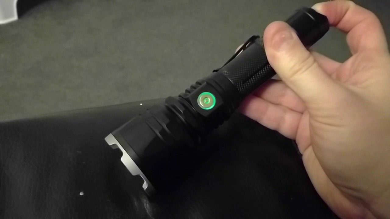

Seems something was wrong with my light. It’s dead now. All I did was test it with a couple of different batteries.
Just before it crapped out it was showing 220 on the klarus, 147 on the sanyo. It flickered off on the klarus, I put the sanyo in and it sat happily at 200. Then it just conked out all together.
Yeah Banggood and Gearbest are OK with refund or repairs if you give em hard evidence with a video
Just describe that light wasnt performing well, got hot and didnt turn on after that plus noticing the smell of fried electronics, giving em a video showing green charge indicator and push on the tail switch
