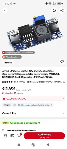

For a project (M21B head with a 519a on a swan neck as an extra light for a microscope) I need a driver that works on a single LiIon battery or 5V and is adjustable via a potentiometer.
I have some of these drivers here: https://de.aliexpress.com/item/1005001297847362.html
but they don’t work too great since the potentiometer isn’t really working fine enough, it’s at 100% at like 60% of the way and shortly before that it makes a jump from 600 to 900mA.
Also, 900mA is a bit too weak. The head can cool 1.5A easily.
Does anyone know an LED driver that has a potentiometer to adjust it and works fine with my layout?
Thanks!
